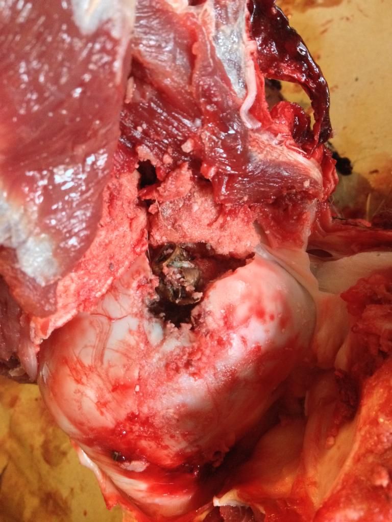

Impressive to hear that Scotty and JD, I have at least one box of 180 Ballistic Tips and 3 boxes of Accubonds of the same lot. I just loaded some Accubonds this morning from 78 to 78.9 grains RL26. I am nervous about using Ballistic Tips on the shoulder bone on those nilgai. My last hunt I bagged two nilgai cows, they are crazy tough animals. A decade ago, I shot a trophy bull head on to the chest with a 250 grain GameKing with a 338 Lapua at about 150 yards and that bullet shook all that dust off its hide and it only buckled a little and took off running about 100 yards over a ravine where it collapsed. The bullet is somewhere in the pelvis area, could not find it when we gutted it and sent it to the processor, no idea on the state of that bullet. I also have shot several nilgai bulls with the 7 STW and 150 Swift Scirroco many eons ago, all pass throughs at the crease behind the shoulder and they always run off. Tracked them down soon after. A few nilgai was hit in the neck and dropped so fast. I have heard many bad experiences with some hunters shooting nilgai and they were lost when they went to day hunts and had to pay for the animal even though they never found it. Even a few hunters had put 4 to 5 holes in a few nilgai from poorly placed shots or wrong bullets for the job was used. On my last cow nilgai hunt, I shot the first one at the crease of the shoulder and exited with the ELD-X 200 grain , I felt it was sufficient to put her down fast but I was wrong, found her after a extensive track job, she was going in a maze in the thickets and I felt I was going to lose it and pay for the animal, lol. Even I was taken back by surprise when I hit the 2nd nilgai square on the shoulder bone and shattered it, and it took off on 3 legs dragging the broken shoulder into heavy brush. Tracking was so hard because barely no blood was found the first 60 or so feet from the hit site due to the elasticity of the hides where the wound closes up. The ELD X only broke one shoulder and shredded the lungs and never touched the opposite shoulder, probably due to coming apart after exiting the shoulder on the inside. That haunted me for a while and I decided to drop the ELD-X and never use it again on big game like nilgai. I won't mind using it on a red stag, not as tough like those nilgai bruisers. On my next nilgai, it won't be at the crease of the shoulder I will be aiming at, it will be right on the shoulder. I aim to drop it at the spot after all the haunting experiences on my last hunt when we could not find one single drop of blood the first 60-80 feet in 3 to 4 foot high grass. :ROFLMAO:. I don't doubt you Scotty or JD that the 180 Ballistic Tip has a thick shank at the base, its a tough bullet but has a tendency to separate from the core if the impact distance is close and I have confidence with the Ballistic Tips to perform on many types of big game, I would love to try it on red stag. I still have that 180 AccuBond that traveled the length of a red stag from the junction of the neck / shoulder all the way to the rear leg, just about an inch or so from exiting. I was dang impressed at the perfect mushroom and penetration. The Ballistic Tip can come a close 2nd in performance if the impact distance is not too close. It's the what ifs if heavy bone is encountered that I am worried about, just those nilgai is soo dang tough, even tougher than bear and elk. I would love for you to come down and try one, you would be surprised by the toughness of those animals, ask me how I know. Harvested about 15 of them all my life, and its by far are the toughest critters I ever shot in my life. My aim is to break both shoulders. Mono bullets will work, but I like the AccuBond.
