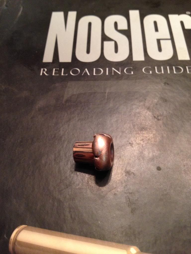

35 Whelen 250 gr PT at 2450 fps recovered in 7th water jug.
And a few more recovered from everything but jugs. Some hardwood and dirt banks mostly. Scotty

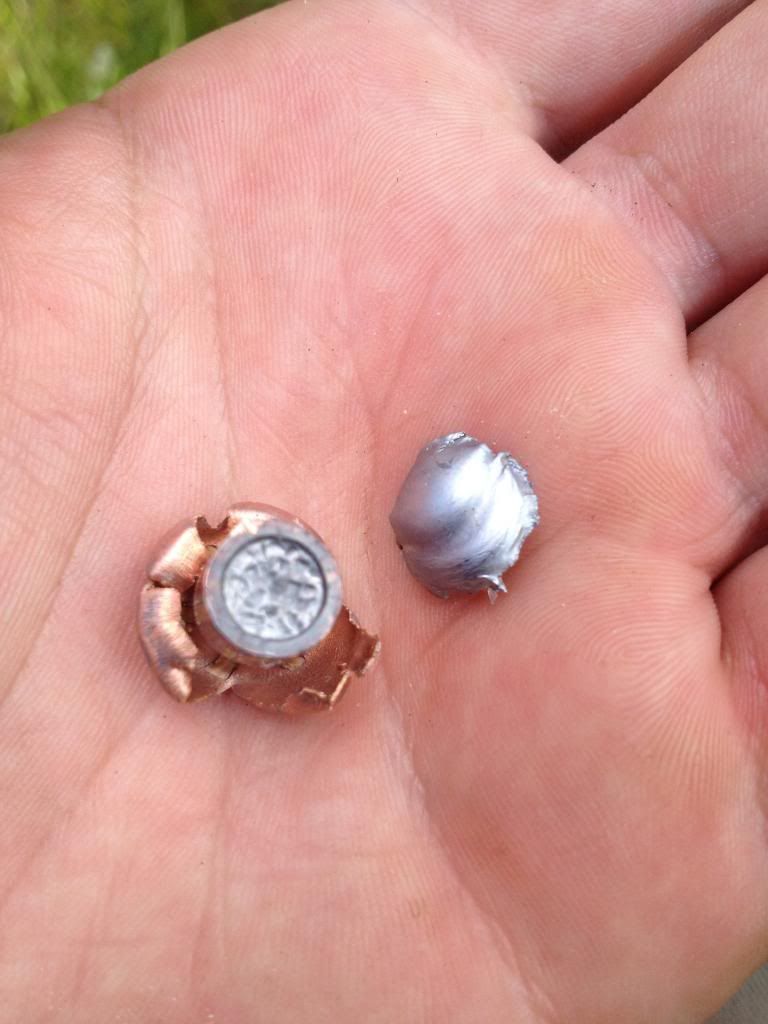

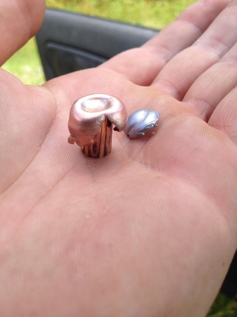

I went out today and just shot some jugs. Brought 20 of them with me, figuring I'd have enough to try out three bullets.. Well, the Whelen smoked that idea.
I chrono'ed the load first and shot on paper to make sure it was okay. Ran 2662 FPS over my chrono today. Probably around 90* around here or a little better today. Usually runs around 2630/2640 FPS or so.

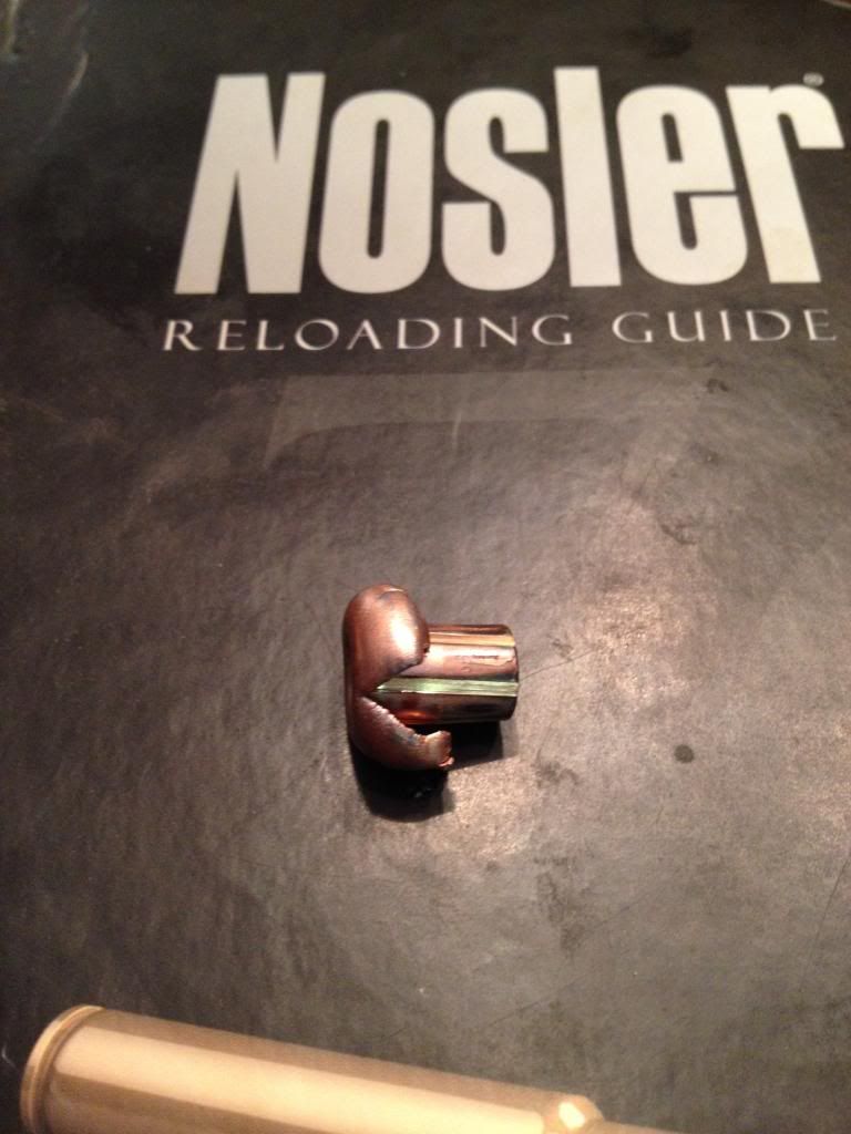

Either way, I found this bullet in jug number 8! Yeah, that's right, I recounted and recounted, but it was there. Lucky to, as I was only expecting 7 but set an 8th up, jug to catch if needed. Glad I did.
Retained 204.6 and expanded to a .680" diameter. Very impressive bullet. Lot of shank on this bullet.

That's a great load there Scotty, for a bullet that's 66 yrs old, it's still one of the best around!..That bullet is picture perfect!. 8)
