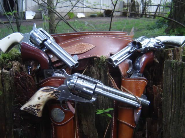

I traded my 270 rem 700 adl, along with a little cash, for these. The long one is a Uberti 1873 cattleman and the shorty is a Cimarron Thunderer.
I like em
Do any of you guys have any 45 colt loads?

Thanks Pop.
I guess I could call Uberti and ask but, would these be considered strong action because they are recent production?
I'm sure Uberti will tell me not to use hand loads just like any other manufacturer.
I like em

Those are some fine looking wheel guns. I do like them. Great pictures again.
