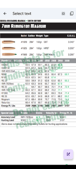

Sierra has load data

ok, so here's what I wound up with. I loaded 5 each of 65gr and 65.5 gr of H4831sc with a coal of 3.31"
The groups were not impressive and both averaged around 1.5" but I know it wasn't my best day.
I can try running 66gr and a little closer to the lands but I'm not sure if I should make both moves together or separate.
If it were me, I'd try 3 shots with 66.0 grs at 3.310" and 3 shots at 3.325". (Make sure this length fits the magazine and cycles).
I'd also try 3 shots with 66.5 grs at 3.310" and 3.325".
That should tell you what your rifle likes.
3.325" definitely tightened things up a bit. I am wondering if I should try 66.25gr
The best group so far was 3.325" with 66 gr
What was your group size?
Maybe try 3 shots 66.25 grs @ 3.325" and 3.330".
