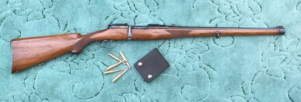

Your 17.5" barrel sounds like it's a 'Stutzen' (Full Stock) carbine usually with an 18" barrel.. I have 2 MSch M1903 rifles - one is a stutzen & the 18" barrel is fine with MV with the 6.5x54MSch cartridge. These rifles were used in the early 1900's in Arica on big game by some well known hunters of the time. Also later when Rigby introduced the .275 (7x57)

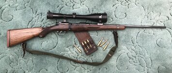

I had the shot out barrel on my M1903(Half stock) replaced with a Krieger barrel here in UK to the exact same chambering of 6.5x54MSch & it's superbly accurate. The gunsmith profiled the new Krieger barrel alongside my original barrel & did a great job. Didn't have to make any changes to the rifle stock.
