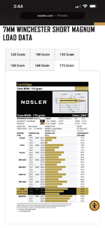

I am loading for a factory Winchester m70 in 7mm wsm. I already have some 175 ablr’s and rl26. Would you expect these to stabilize well in a 1:9.5 twist barrel or should I look for some 168’s? Any other concerns you might have loading this long of a bullet in the wsm? Nosler load data shows this option so I’m hoping it would be ok
All thoughts are appreciated
Nosler’s loading data for the WSM with a 9.5:1 , so I would say you’re good to go.
That seems like a fair assumption to me too, but I was wondering if there were other considerations- perhaps the BC may be compromised with the slower twist, or if there were other constraints that could limit this combination. For instance, Nosler gives data for this bullet in the 280ai also but only loads the 150 ablr. I’m sure there’s a reason for that.
The 175 ablr (if it shoots in this gun) could have great potential. Alliant’s website shows about 3050fps with rl26. That is nipping at the heals of my 28 nosler with far less powder
