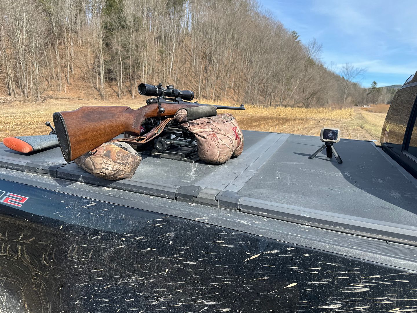

Some really fine stats with that load.Smacking steel yesterday with the 300 H&H Also had the 257 and the 275 with me. First five shot series out of the 300 HH as recorded on the Garmin. Brass was once fired as near as I can tell, 1960 vintage. 69 gr. RL 19, 180gr Partition. CCI Mag. Primers. I just now noticed the date and time are incorrect. I should fix that I guess.

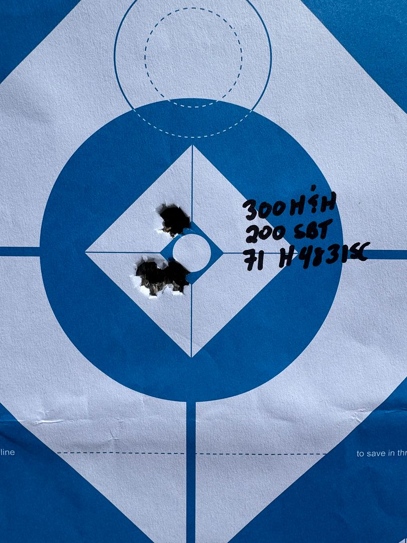

That is outstanding work. Those 200s should work on everything short of elephant.I’ve had a blast working with my 300 H&H as well. Finally settled on H4831 and Sierra/Nosler 200’s just a smidge over 2900. Need to get it out again and get my zero squared away but it has been a pretty accurate rifle, no free floating, or carbon stock, just wood and metal with the barrel bolted to the stock..
Yep , that will work.I’ve had a blast working with my 300 H&H as well. Finally settled on H4831 and Sierra/Nosler 200’s just a smidge over 2900. Need to get it out again and get my zero squared away but it has been a pretty accurate rifle, no free floating, or carbon stock, just wood and metal with the barrel bolted to the stock..
Hard to beat that consistency!Smacking steel yesterday with the 300 H&H Also had the 257 and the 275 with me. First five shot series out of the 300 HH as recorded on the Garmin. Brass was once fired as near as I can tell, 1960 vintage. 69 gr. RL 19, 180gr Partition. CCI Mag. Primers. I just now noticed the date and time are incorrect. I should fix that I guess.
