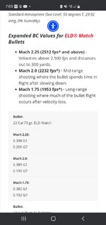

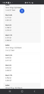

velocity affects the bullets BC . as velocity drops so does the BC . I've never used strelok . in the strelok ; is there a way to true the BC ? are you using the G7 BC numbers ? did you get a good velocity from a chronograph ? how did you pick the G7 BC number ? if you're using the Nosler BC numbers they are probably high . the little things show up big as you shoot longer distances .
