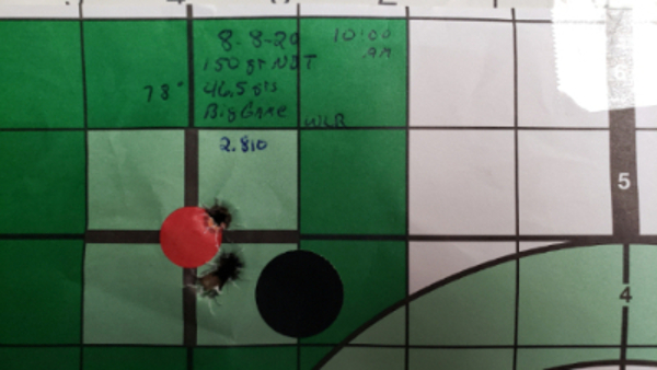

Don't have the 150 AccuBond in my QL bullet profile, but I'd feel comfy using the BT data to work up with.
We use the 150g NBTs in the Wife's Kimber 22" mountain rifle with RL17 at 46.5g I believe, for 2825fps and 1/2-3/4 MOA. I know it's not the AB, but it's pretty close enough anyway.
It's a good little load for a 7/08. About perfect at those speeds on deer and elk out to 500 yards, which is far as she can shoot anyway.

I get 2780 with 150 ELDX and superb accuracy, BG powder.

As with both, it is just a guide to get you started. I pay more attention to the speed and pressure than pure charge weight. Brass difference and gun difference seems to make more difference in the actual speed than the listed charge weights.
Case in point is Nosler's 130 data for a 270. I haven't ever had a 270 that'll come close to 3100 with 59 grains of any variety of 130's and H4831.
