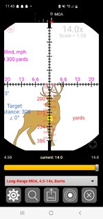

Got the Burris 4-14x mounted up in some leupold rings. If I was a betting man, I'd say the factory picatinny rail on this is going to be the weak link. It's pretty cheesy, and to be honest these Leupold rings aren't a whole lot better...I got everything degreased and torqued to specs, so we'll sight in and see how the mounting system holds up over a box or two of shells. If all else fails, I'll just end up ordering a DNZ mount for it. I should be able to get out to around 400 yards with the Burris LR MOA reticle on 14x. Picked up a couple boxes of Hornady 300g HPs, Starline brass, and RCBS dies. Cant wait to see what it can do!
