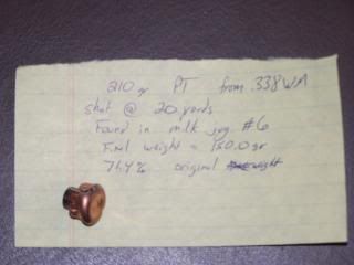

Rifle #1 Winchester 338WM with Minox 3-9. I really like this scope. I did not shoot the greatest group at 100 yards with it. I did shoot a 2.625" group at 186 yards on a steel gong. My main goal for the .338 today was to get a 210gr PT from a jug. I shot at 20 yards and got it in the 6th jug. I will keep playing with this rifle. If I can shoot 1.5" at 100 yards I am calling it good.

Nothing to really say WT, other than great shooting, awesome recovery of the 210 PT and that 25-06 sounds pretty awesome as well.

Man, those partitions are flat predictable. :lol:

Nice work recovering the .338 bullet too. You're getting things done real well.
