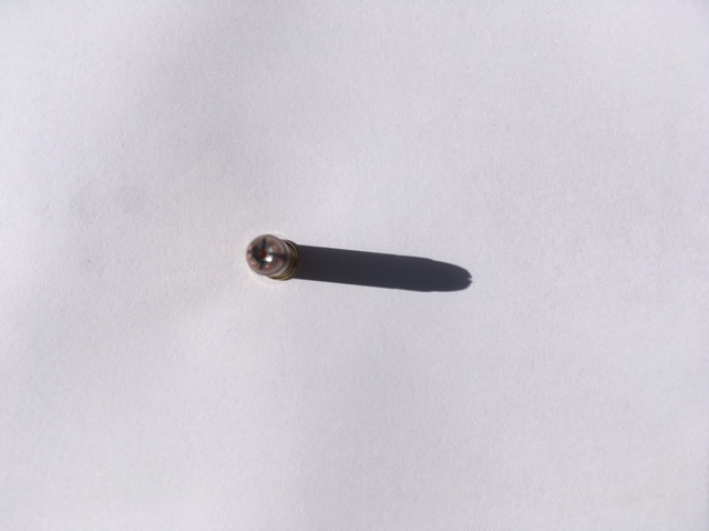

1st pic shows the cross cut that was added to the already modified hollow point.
Side view. Not great pictures but you can see the small skive cut down the side of the jacket.

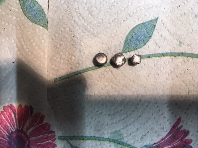

It went into the jugs somewhat less of a distance than the modified hollow point. Was laying between the 2cnd and 3rd jug instead of making it into the 3rd jug. Was 5% more expanded than the modified hollow point. The cut bullet measured .365.

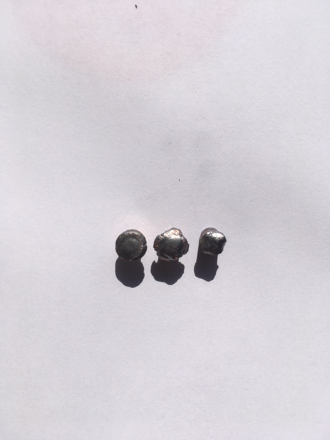

The 2cnd test was with a bullet that was cross cut deeper. At least 2 to 3 times deeper. That bullet appeared to shear off the petals so to speak and was pretty much just the bullet shank left. Was in the 4th jug and measured .275.
That bullet also weighed 5.5 gr's less than the other 2. That 5.5 gr's went somewhere...….if it shears off in the first 2 inches it might be useful even though it didn't show up in the jug test.

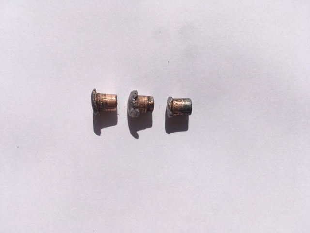

Pic shows the original modified bullet on the left, the shallow cut bullet in the middle, and the deeper cut bullet on the far right. You can see the distinct 4 corners of where the cuts were on the far right bullet.
Another pic of the same.
A side view of the bullets lined up left to right the same as above. Middle bullet in particular with the shallow cuts on top of the modified hollow point is the clear winner it appears on all fronts for what I'm after.
