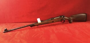

I used to own a Sako 85 Bavarian in 25-06. Sold it stupidly and have regretted it ever since.
Well, found something and immediately bought it. Should be here tomorrow.
It’s a Sako 90 Bavarian in 6.5x55 Swede. Lefty, of course.
Can one of you fine gents run a QL for me?
-127gr LRX at 63k PSI, want to see what powders would be best for the task.

Appreciated, Dr Mike!
Curious, and this isn’t from the data provided, most load data I see includes H1000 and I see RL26 often, but I never see anything about Retumbo which is in the same burn range. Why is this?

That makes sense. Thanks!
Nice find!
Very limited numbers get shipped to North America each year.
I tried for a few years to get the same rifle in 9.3x62. Finally went with a Hunter.
Your rifle should prove to be a shooter!
A mouflon hunt would be a great adventure with that rifle!
Would love to do a similar hunt with my LH Steyr Mannlicher Model M SE in 6.5x55! (And add a fallow buck to that hunt too!)
Between you @nhenry and @Blkram you guys sure have some nice lefty rifles! That's a beauty that you'll love. Easy cartridge to load for, powders in the various 4350's to the H 4831 sc are the best all around powders from what I have seen over the years.
