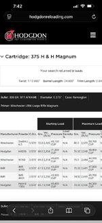

I asked my PH if he had any issue with me using my 375#1 for Cape Buffalo. He wants me to practice reloading speed and to use swift A frames. I have a good load with RL 15 and Nosler’s but I only have 1/2 pound of powder left. The Vihtivori powders get good speed. At the moment I can’t find any 300 gr. Swift A Frames.
Don
I’ve been looking for 300 gr AFrames myself and they are nonexistent. North Fork and Trophy Bonded Bear Claws are also unavailable.
Barnes TSX isn’t a bad choice and they’re available.
It took 85grs of N555 to break 2600fps behind the Hornady 300gr BTSP in my 375 Wby. N555 seams a little bulky and a slow burner in that case.
Good intel, thanks I saw Vihtivori showed it for the Barnes tsx but not the Swift. Have you used 540?
Don
300 gr tsx is second choice with my PH, partitions third. I’ve 50 weeks to get it figured out:) I have tsx on the way and I’m shooting some Partitions and Accubonds tomorrow.
I have not tried 540. Most powders I use are around the RL-17. I know JD has had good luck with Sta-BALL 6.5 in his 375. Hodgdon list it at the top with the 300gr Swift.
Shoot I think I have some 6.5 in the back, down on the bottom of the cabinet. I’ll give it a whirl next week.
