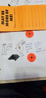

Maybe try .060" off the lands.The weather wasn't my friend. I was fighting the rain trying to get these rounds out. I'll break it up into two post.

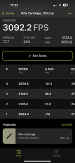

This is my JD Special - .050 off the lands. 100 yard shots
I cleaned the gun prior to shooting these 10 rounds. My first shot was a fouling and temp shot that hit dead in the bull. I gave 2 minutes between each shot until 3 shots. Then I let it rest 10 minutes.

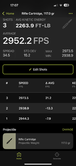

My Sd and ES on this load were better than what I was getting with H1000, and the group was better. My FPS was higher than any of my loads with H1000 as well, although that won't be a huge factor for my FIL because he shoots inside 200 yards in most cases. Going center to center this group measured 1.432. The lower shot was my first, the two next to each other were shots 2 and 3.
View attachment 26567View attachment 26568View attachment 26570

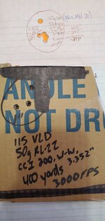

49grs for the Fusions and 51grs for the GK.What charge weight did you do the 117's at with IMR4350?

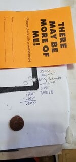

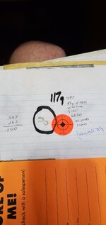

Here is everything the same but .060 off. I'm going to try bumping the powder to some of the levels these guys mentioned in this thread. Once I see those results, I may put a fork in this thing and call it good. This time my 3rd shot was the one out of the pack. Maybe it was me.. hard to say. That's the best group I have got out of this gun though.Maybe try .060" off the lands.
Don't clean the barrel. I think your almost there.
Maybe I'll try the seating depth first and keep backing it up. No reason to stray away now haha.If it were me, I'd use the same charge weight and try .065" and .070" off the lands. You should be about where you want to be.
Nice shooting.

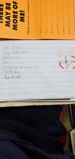

That's a good point. I haven't done that because this gun gets hot pretty fast. Even with a two minute cool down between shots, after three I have to let it sit for 10 minutes or more. If the sun is out, I take it to the shade even. You're right though, larger sample size gets better results. My typical is to do three shot groups, dial in, then i load 9 rounds of what I consider my final and shoot them all at the same target.Definite improvement. Just on a whim, try loading 4 rounds when shooting for a group. You questioned yourself if the shot pulled was you or the load. With 4 shots you get another chance if you pull one. Just a thought.
Understand about the barrel heating up. This time of year, I spend more time cooling the barrel than shooting it seems.That's a good point. I haven't done that because this gun gets hot pretty fast. Even with a two minute cool down between shots, after three I have to let it sit for 10 minutes or more. If the sun is out, I take it to the shade even. You're right though, larger sample size gets better results. My typical is to do three shot groups, dial in, then i load 9 rounds of what I consider my final and shoot them all at the same target.
I have 100g Speer that he wants a load for next. Do you suggest going lighter than this? I'm cleaning the gun and going to put more rounds down range later on.Just for grins and giggles try a lightweight bullet.
