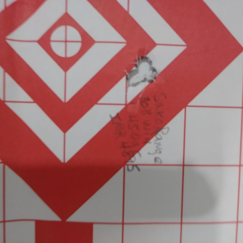

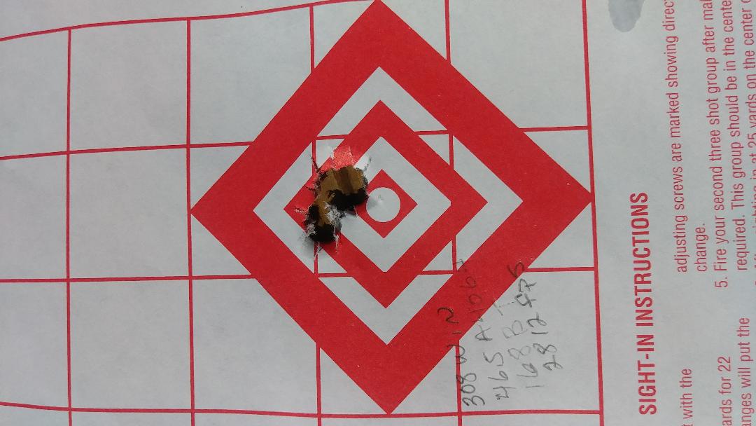

I have a Sako A7 Long Range 308 Win.It has a flimsy stock and I never could get it to group well until I full length bedded the stock.It shoots really good now.
Some of my loads:
150gr Nosler Ballistic Tips
46.5grs of Varget
45.5grs of TAC
168gr Nosler Ballistic Tips
44.5grs of TAC
45.0grs of IMR 4895
45.5grs of Varget
46.5grs of Accurate 4064
Some of my loads:
46.5grs of Varget
45.5grs of TAC
44.5grs of TAC
45.0grs of IMR 4895
45.5grs of Varget
Definitely some fine accuracy. (y)
TX, thanks very much For the load data. My stock seems solid to me, is yours the rough texture green synthetic ? I’ll double check mine. It’s free floating from the action forward. When I got it I separated the stock and action, it seemed to be bedded to me. I’ll look again.
