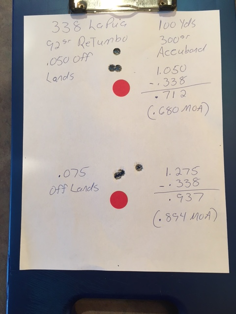

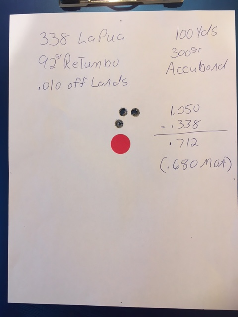

Just for kicks to see if anything would turn up better than that, last week I shot 3 at .010 off, 3 at .050 off, and 3 at .075 off. Nothing was better, but still shot well.
The .050 off and the .075 off. Out of 24 shots total the .075 off was the worst group it produced.
The .010 off from last week.

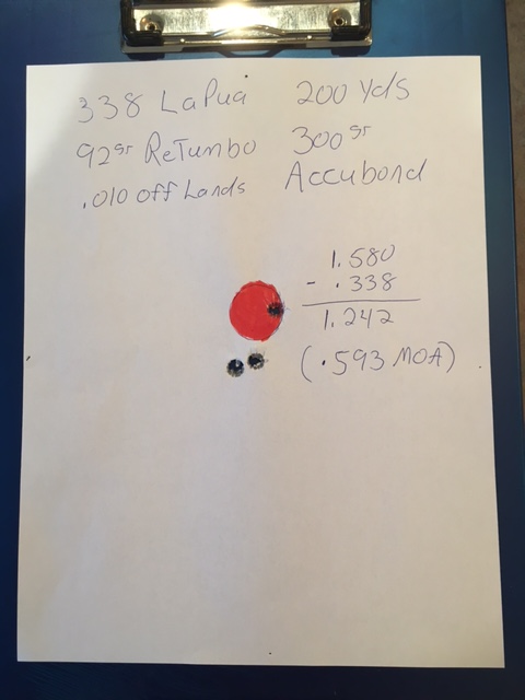

Last evening I shot the .010 off at 200 yds. Still clicking right along. It consistently shot a tad better at .017 off, so I think I have my buddy convinced to just load at .015 off and call it a day. Next we test the .015 off at 300 yds, then onto stretching it out at distance.
The .010 off at 200 yds last evening. I have to be careful here. Don't want to be accused of claiming to have been all along shooting a sub MOA rifle. :shock: :)
Yup, looks as if the rifle wants to shoot.
