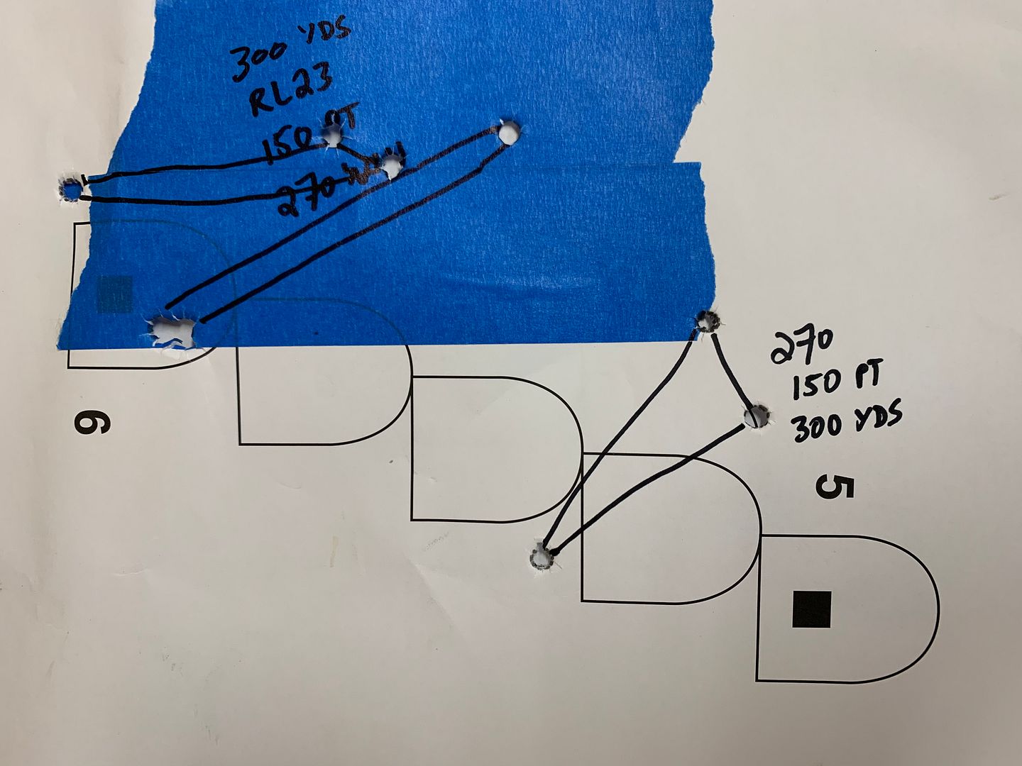

Shot the 150 Partitions out to 300 yards last night. Still getting a little 2-1 action going on with this load. I believe I'll try shortening them up just a skosh to see what happens, but when I consistently get two close and third winger it drives me crazy. Pretty nice shooting little rifle. Hard to beat them little Tikka's for a light carrying rifle.
