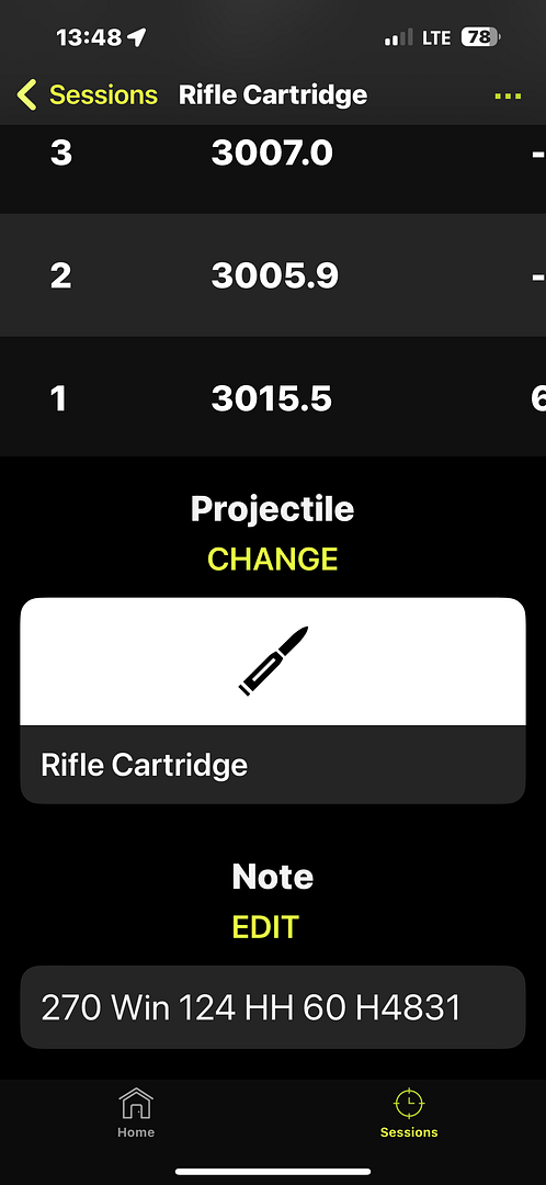

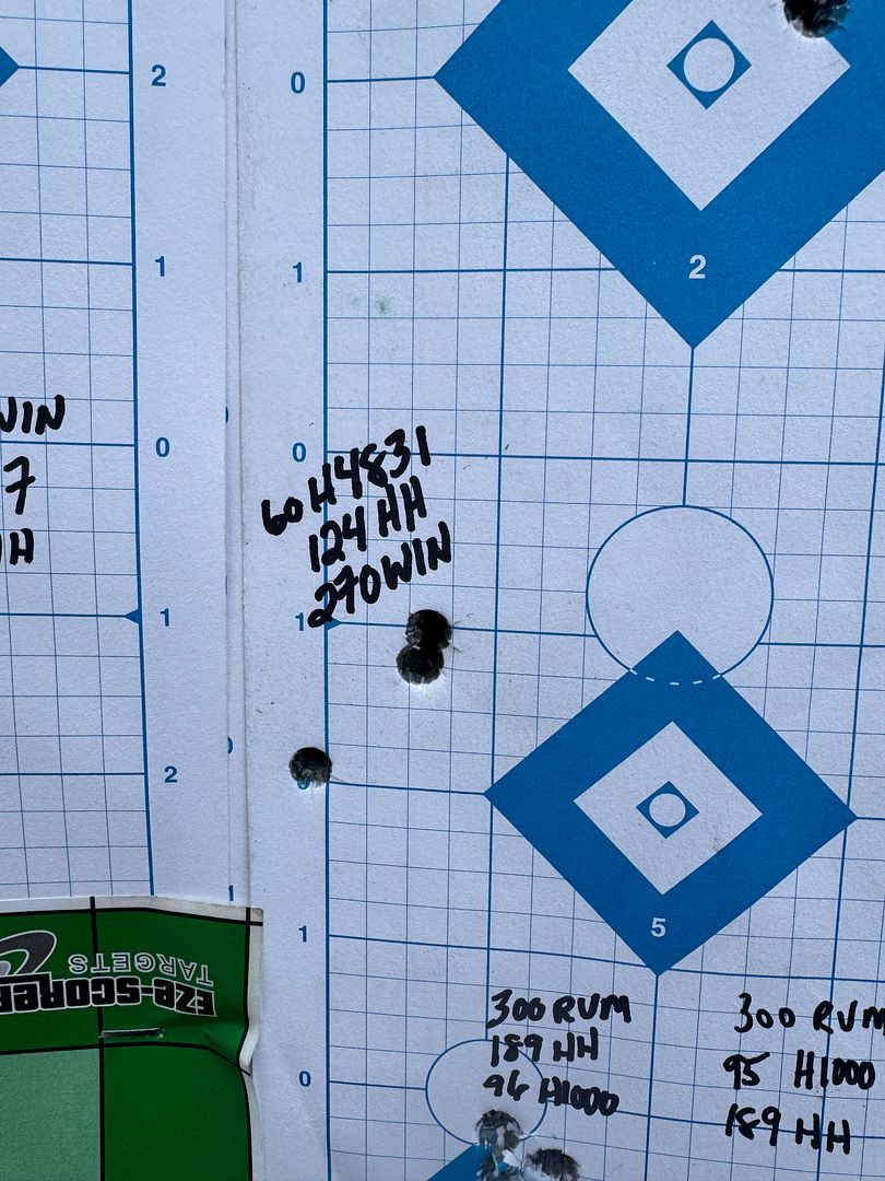

I decided to get one of my favorites out and see what I could do with the 124 Hammers. I am using some old WW brass (new) and CCI200's. I started them .050" off the lands in my rifle which resulted in a 3.200" COAL for them.
60
That charge was right at 3009 average, so I kept pushing up.

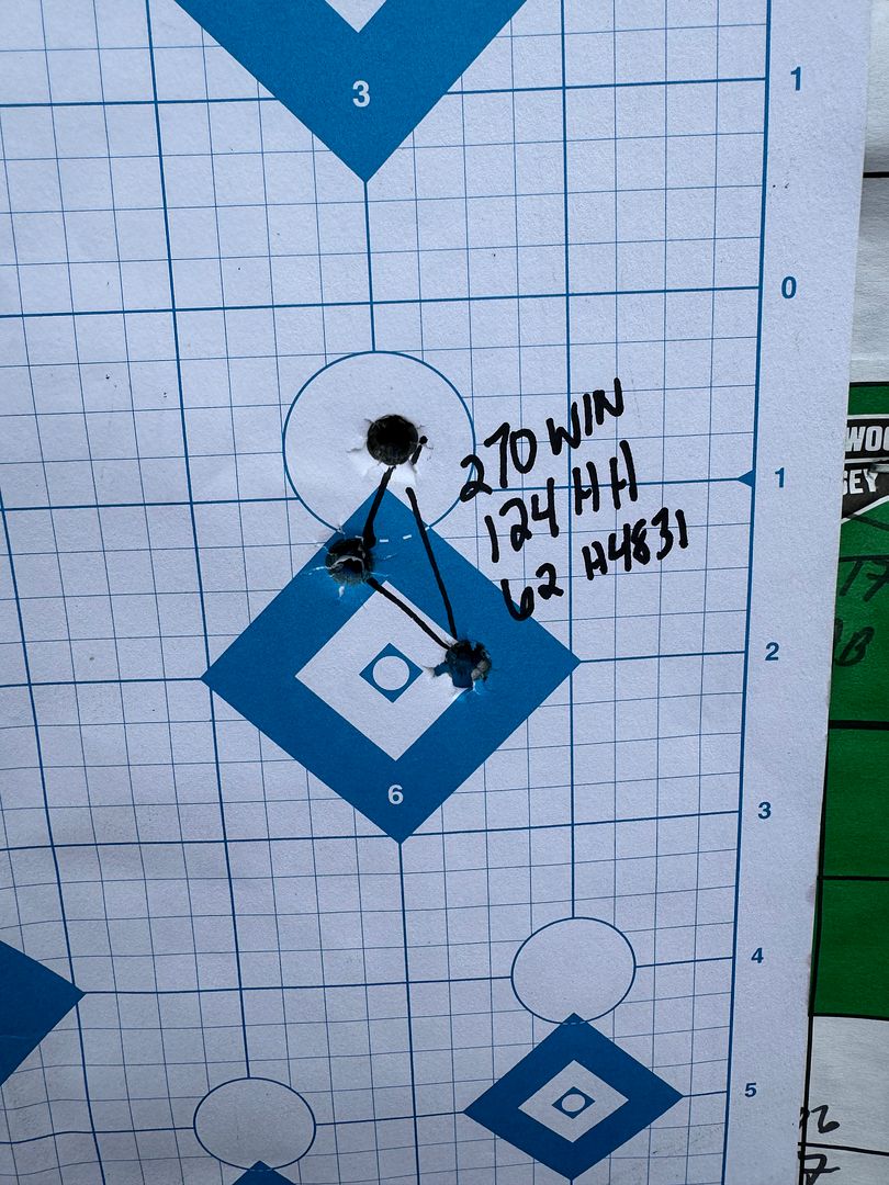

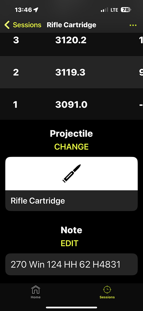

62 went 3110 average.
I loaded up another couple charges a bit higher and shortened them .020 for the next trip out to see what happens. But overall, I wasn't terribly disappointed on how they ran on their first range session.
