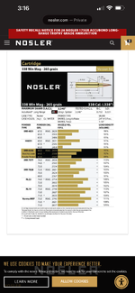

I was just contemplating a 265 Nosler around 2700 might be nearly possible in my 338 Win. Running the numbers it’s fairly impressive. Might make it a 338 year this year. Been awhile since I’ve taken the old Alaskan on the hill.
For sure. That 250 AB touches down with some serious juice.
