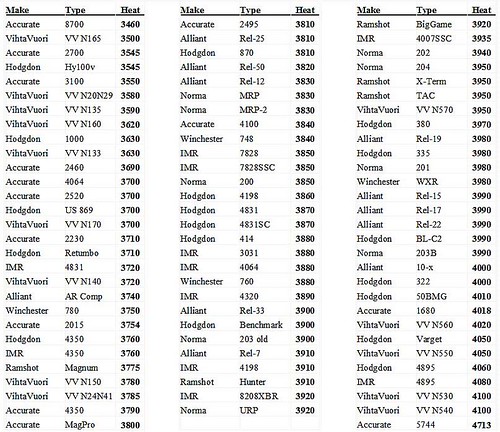

I would like to load down to the 2.950 fps range. My chose in powder is H1000 or US869. Barrel life is an issue. The H1000 Load uses 77.5 gr vs US869 90.3 gr for the same velocity. Does the burn rate of the H1000 trump the difference is powder charge of the US869 in terms of preserving barrel life?
Use the powders you have and find what your rifle likes best...Then go shoot and kill stuff with it.
Don't worry about your throat life. Enjoy! Shoot steel!
I run a 26 Nosler, and I am going to shoot it until it no longer has acceptable accuracy, then replace the barrel
