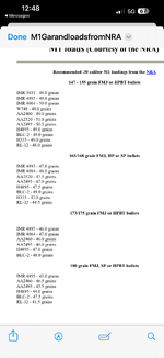

M2 loads
47.2 of IMR 4895 with 175gr in Military 30-06 brass
