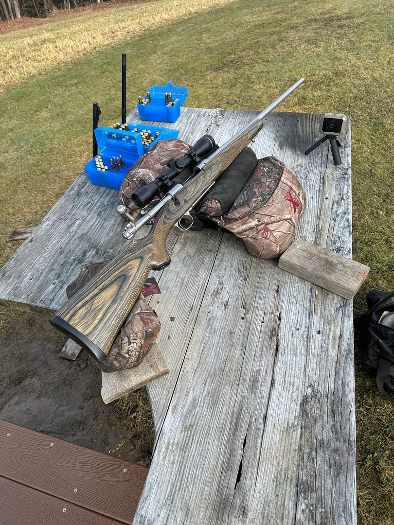

We have similar tastes in our 338-06's! Here's a pic of mine:
LH Rem 700 w/ a 22" King Barrel, NECG Barrel Banded front sight and rear sight, in a Wenig laminated stock with ebony fore end and grip cap, a LimbSaver recoil pad, and all metal tefloned. Leupold VX-3 3.5-10x40 B&C in QR rings and bases.

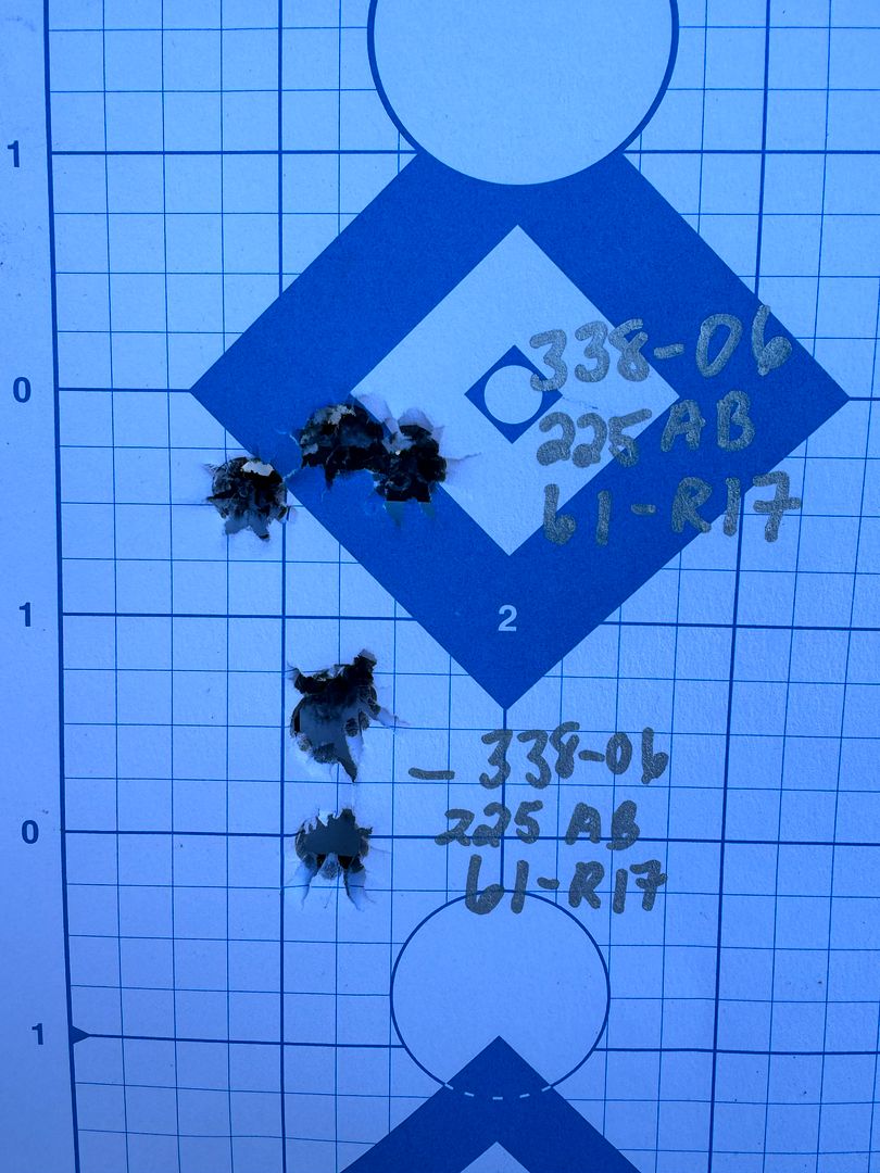

I did mine on a whim. I picked up that SS Classic for a good price, but already having a couple 06's, I decided to make this one a 338-06. Focused on the 225 AB with one of my favorite powders, RL17 and man if I wasn't real happy with the outcome. I do have a Bansner stock I could have fitted to this rifle as well, that would lighten it up a bit if I wanted to take it elk hunting, but as it sits right now, I may give it a run for deer this year. It's little brother the 338 Fed in the baby Kimber is about the perfect rifle for me around home, super light and it just plows stuff.. It's fun to have choices.

My new-to-me 338-06AI likes the 225 AccuBond. I want to try RL17. Would you share a load that works for you? There’s little published load data for it.
Of course, I can use 4350 charge weights as a start.
Thanks.
