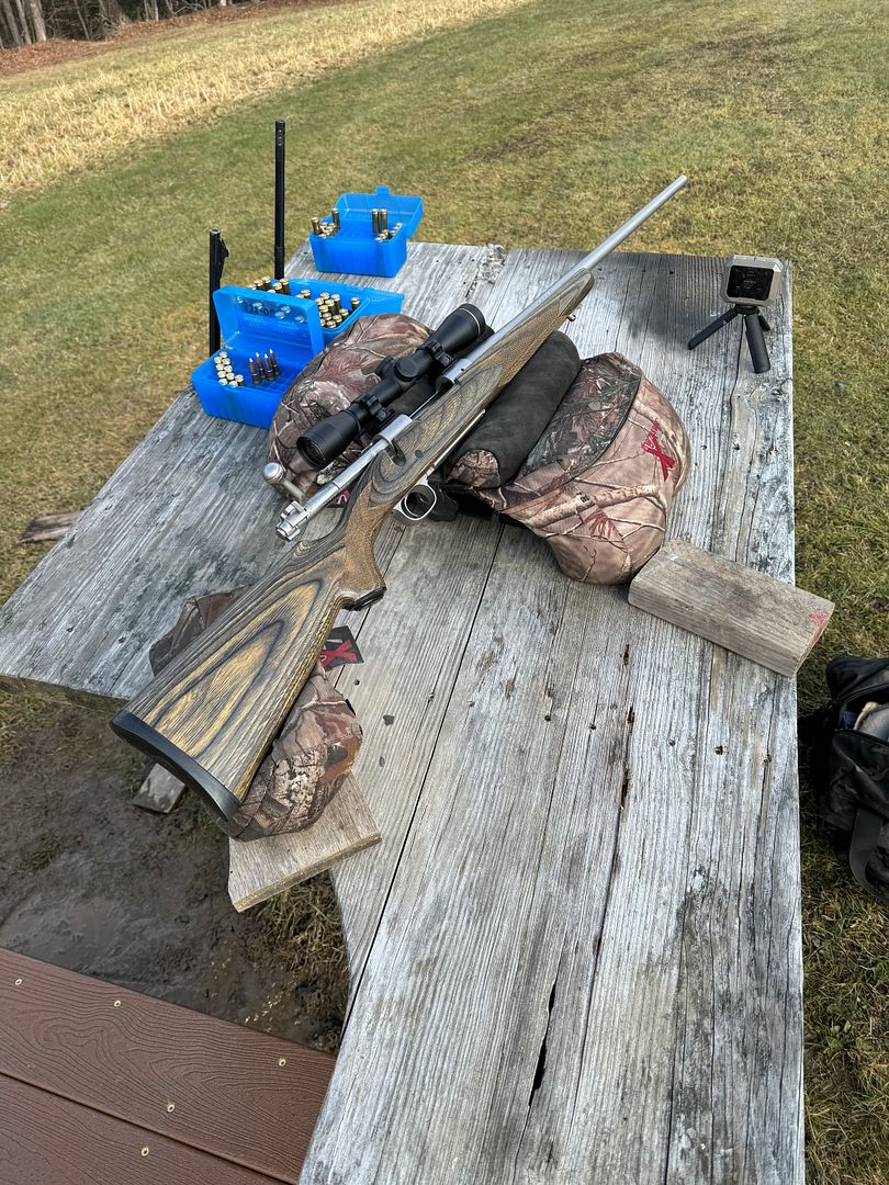

I had a SS M70 Classic in 30-06 in my safe for quite awhile. It has the grey laminate stock on it and for awhile I couldn't decide what to do with it. I already have one great 30-06 so decided to send it off to JES for a rebore. I sent him a dummy with a 225 AB for throating, knowing that it would work fine for about any reasonable bullet I will use in it. Anyhow, got the gun back from JES and loaded 50 rounds up with 52 grains of 4064. 1/2 with 225 Hornady SP's and the other half with 225 Speer BTSP's. I'd shoot it 10 rounds and clean it back to bare metal. Well, once I'd worked through all the brass, I decided to try the 225 ABs. I have quite a pile of them and they are a good enough bullet for anything I'd tackle with it.

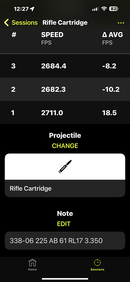

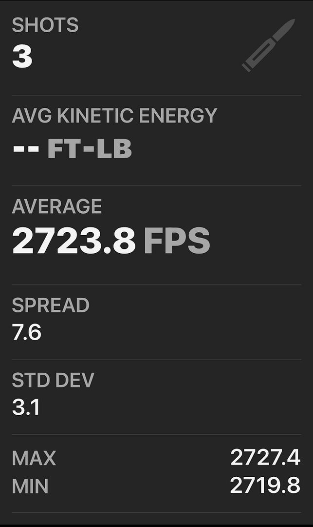

Well, now I am thinking I will shorten them another .010 and see what the paper says. Speed looks decent right at 2700 FPS.

The rifle is attractive with the stainless barrel and laminate stock. Obviously, it will shoot quite well. A 225 grain pill at 2700 fps will work very well indeed. FWIW, I almost always wound up close to .100 inches o0ff the lands with ABs.

23" is what I measure. I had him cut it and recrown it. Seems fine, 22 would be great as well. It seems like an easy to please cartridge so far.
I am calling this one good enough. The barrel feels alot smoother and seems to clean up pretty decent now. I will say and I may be full of stuffing, but I wouldn't even try to do much load work till you get about 50 rounds through the gun. I cleaned between 10 rounds till I got to 50 and now it seems to be as good as about anything else. They tend to grab copper pretty good till you get it smoothed out, but now, I am barely seeing much in the bore at about 10 rounds yesterday.
