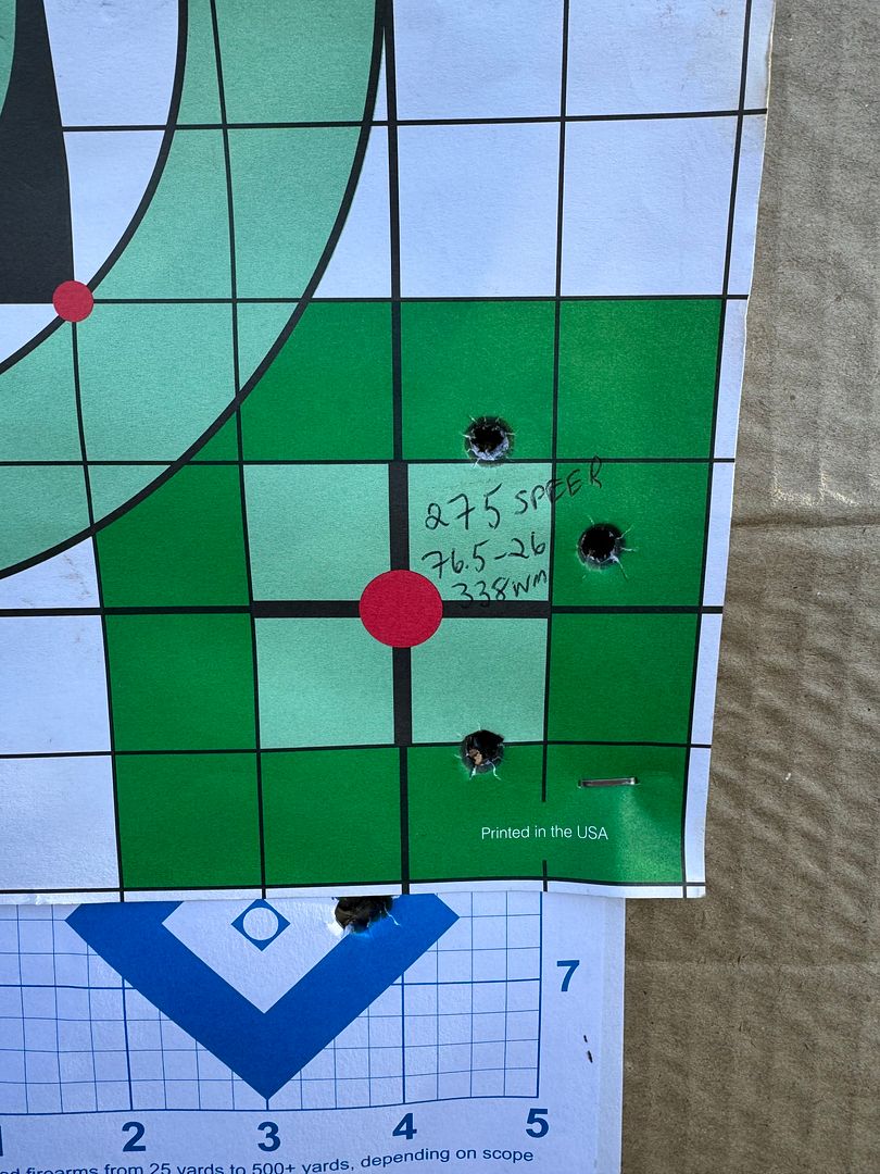

I have had about 300 of these old gems kicking around my bullet shelf for quite awhile. They used to shoot decent in my old 338 with RL22 so I decided to give them a shot in the Alaskan with RL26 to see what'd they do..
Cartridge : .338 Win Mag.
Bullet : .338, 275, Speer SSP 2411
Useable Case Capaci: 74.098 grain H2O = 4.811 cm³
Cartridge O.A.L. L6: 3.340 inch = 84.84 mm
Barrel Length : 25.0 inch = 635.0 mm
Powder : Alliant Reloder-26 *C
Predicted data by increasing and decreasing the given charge,
incremented in steps of 0.658% of nominal charge.
CAUTION: Figures exceed maximum and minimum recommended loads !
Step Fill. Charge Vel. Energy Pmax Pmuz Prop.Burnt B_Time
% % Grains fps ft.lbs psi psi % ms
-06.6 97 71.00 2551 3975 49344 9974 100.0 1.423
-05.9 97 71.50 2570 4032 50572 10001 100.0 1.407
-05.3 98 72.00 2588 4089 51837 10028 100.0 1.391
-04.6 99 72.50 2606 4146 53139 10054 100.0 1.376
-03.9 99 73.00 2624 4203 54466 10079 100.0 1.361
-03.3 100 73.50 2642 4261 55854 10104 100.0 1.346 ! Near Maximum !
-02.6 101 74.00 2659 4319 57272 10129 100.0 1.332 ! Near Maximum !
-02.0 101 74.50 2677 4377 58731 10153 100.0 1.317 ! Near Maximum !
-01.3 102 75.00 2695 4436 60232 10177 100.0 1.303 ! Near Maximum !
-00.7 103 75.50 2713 4494 61780 10200 100.0 1.288 ! Near Maximum !
+00.0 104 76.00 2731 4553 63373 10223 100.0 1.275 ! Near Maximum !
+00.7 104 76.50 2748 4612 65015 10246 100.0 1.261 !DANGEROUS LOAD-DO NOT USE!
+01.3 105 77.00 2766 4672 66708 10268 100.0 1.247 !DANGEROUS LOAD-DO NOT USE!
+02.0 106 77.50 2784 4732 68454 10289 100.0 1.234 !DANGEROUS LOAD-DO NOT USE!
+02.6 106 78.00 2801 4792 70252 10310 100.0 1.220 !DANGEROUS LOAD-DO NOT USE!
+03.3 107 78.50 2819 4852 72105 10330 100.0 1.207 !DANGEROUS LOAD-DO NOT USE!
Results caused by ± 10% powder lot-to-lot burning rate variation using nominal charge
Data for burning rate increased by 10% relative to nominal value:
+Ba 104 76.00 2834 4906 80375 9768 100.0 1.172 !DANGEROUS LOAD-DO NOT USE!
Data for burning rate decreased by 10% relative to nominal value:
-Ba 104 76.00 2567 4024 48933 10791 99.3 1.414
76
76.5
77

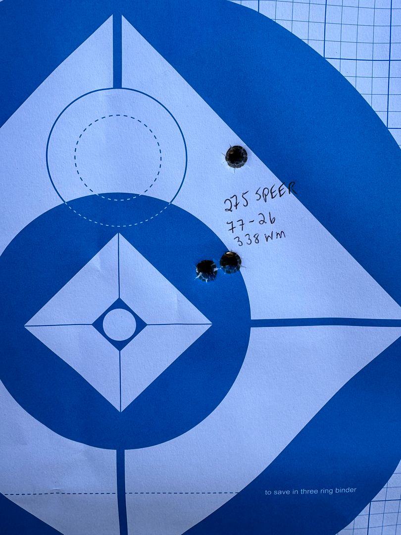

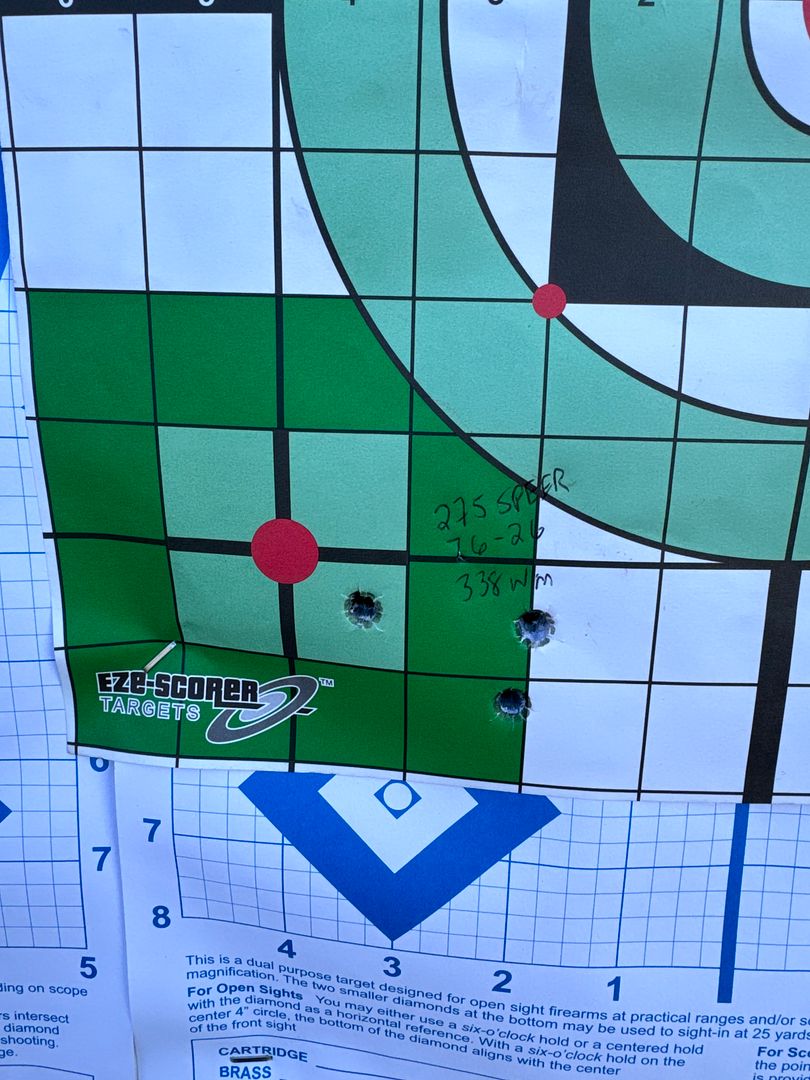

Nothing ground breaking as far as accuracy, but maybe I can work with the seating depth a little with it and see if I can pull them together. Looks like somewhere in the 76.5-77 grain mark will be where I end up. Pretty powerful combo though. I'd love to take that load hunting. Elmer seemed to like them quite alot back in the old days.
That’s about the accuracy I’m getting with the 250gr GS in my 338 WM. Barnes are shooting decent but the Speers not so good. N555 is the powder I’m using.
That's some potent medicine for the big critters.

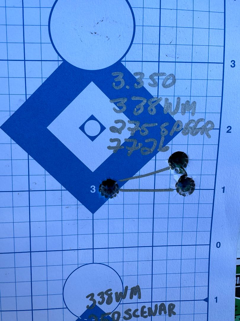

I loaded up some more of them, also went back to another .010 in COAL, so I think I'll find a spot they wanna shoot. I think it'd be cool to use them old bullets on elk. I jug tested them years ago and they went a long way. BC can't be horrible on them either.
