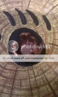

7 RM, 162g SST, approximately muzzle velocity of 2950fps.
Bullet was found in 5th jug. The 162 SST, held together VERY nicely for a non-bonded/premium bullet. The core was still intact, perfect mushroom. I forgot the bullet out at jakes, but was hoping he could grab it, weight it and post the pic.
I havn't forgot about you buddy, things have just been a bit bussy the last few days. I'll get them up this week though.
Thanks for the report Jorey. I have looked at them a little, and would give them a whirl if I wanted a really inexpensive LR bullet. Scotty
Weighed 88 gr.
I was really impressed with this bullet, I have heard from a few buddies that shoot elk with them out of a 7 mag, that they are like tiny bombs! One wouldn't think that by looking at this one.
Wow, Jake, those look excellent. Can't see a thing wrong with that bullet at all. Pretty sleek missile too. Great pictures. Thanks for posting them. Scotty
