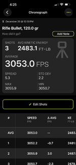

Today got around to shoot some of those in my S2 Vanguard. I’m using American Reloading MP-521 powder , sold as BL-C2 equivalent. This stuff has given me good ES in every cartridge I’ve tried it in. Overall I’m satisfied in the outcome on a small work up.
47grs
48grs

More of a tinkering project , load up some single round to find pressure or run out case capacity then put some on paper. These were rounds 11-16. First 7 were 45-50 grains to see where I would pressure out , done last Sunday. Yesterday 8-10 were shot to warm the barrel.
I now know these will work with a little tweaking if I chose to use them at some point.

I happened to load some 120 ttsx in my 7mm-08 today. My load is 50gr Leverevolution with a CCI 250m primer in Starline .308 brass. Couldn’t find 7mm-08 brass for a good while but I do have some Starline 7mm-08 now. I get 3250fps in a 22” barrel with this load, accuracy is about an inch which is as good as I’ve seen my M70 featherweight shoot anything.
50grs of MP-521 gave me 3196 fps. That was the highest I load up to test. The brass I’m using is the older Winchester brass (the good stuff).
