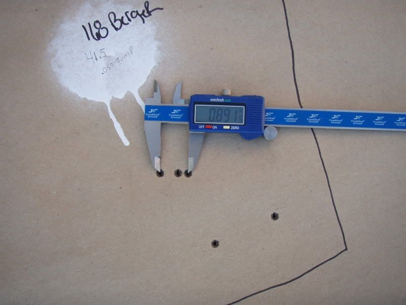

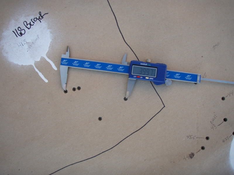

I like the 7-08 . I think it's a dandy deer hunting cartridge . fun to shoot , easy on the shoulder , and I've found it to be very easy to load for . with components being hard to get I think you made a good choice in this cartridge . I have three of them . I have a tikka 595 , that I'm shooting 139 BTSP with IMR4064 powder getting around 2800FPS . I have a rem 700 with a broughton bbl that I'm shooting Berger 140 hunting VLD's with RL 17 powder getting around 3080 FPS . then I have my girlfriends Browning X- bolt using 120 ballistic tips with a reduced load of H4895 no chrony info . all will shoot well under an inch at 100 yards . my opinion , I don't think the 7-08 has the case capacity for using heavy bullets . I did play with Berger 168 hunting VLD's , it was slow . I stupidly pushed it waaaaaay past max powder load to get the velocity up . case life was short , and the accuracy was not there . when I dropped back to a more acceptable powder charge the accuracy came around , but the bullet dropped like a rock at longer distances . I never played with bullets in the 150 grain range , this could be a happy medium .
this is the whole target shot @ 200 yards
center dot on target . Tikka using IMR4064 with a 139 BTSP @ 200 yards .
upper right on target . rem using 140 VLD's with RL17 @200 yards
X-bolt shot @ 100 yards . reduced load of H4895 with a 120 ballistic tip .
rem shooting 168 VLD's with RL17 powder @ 400 yards . I shot 3 let the rifle cool and conditions must have changed , or I got the jerks , for the other two shots . you can see the velocity I was getting with a safe powder charge .
even with the jerks it shot moa @ 400 yds .
