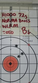

First group I loaded shot very well 71.7g h1000 but had a pretty bad deviation. Next group 72 not as good better deviation but still too slow and deviation. Actually had slower speed at the higher powder charge. I wonder if I started with too much powder to start?

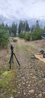

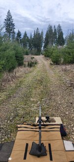

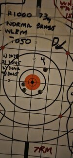

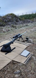

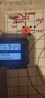

Thursday eve range report, 4 groups all with H1000. Loaded two 5 shot groups with virgin Peterson Long Brass and CCI 250 primers each of those two groups had a large flyer but deviation better and 4 of 5 looking pretty ok. I will be going with the CCI 250 primer from here out. Not sure the reason on large flyers but possibly burrs. I had a hell of a time deburring the virgin Peterson Long brass the burrs seemed to really be hard and cutter just could not get a bite, however ran them as they needed fireformed and figured I could try a different primer in them as well. Actually sized those pieces today and were much easier to chamfer and deburr.
Also moved up in powder out of the 4x fired Norma brass. I had 7pc did a 3 shot and 4 shot group. Both poor deviation one of the 2 close to moa.
I'm thinking next trip should have some good results the seating I think is close, I also think it likes the cci 250 primer better, and will be using fresher Norma brass or Peterson Long fireformed. Thanks for the feed back.
