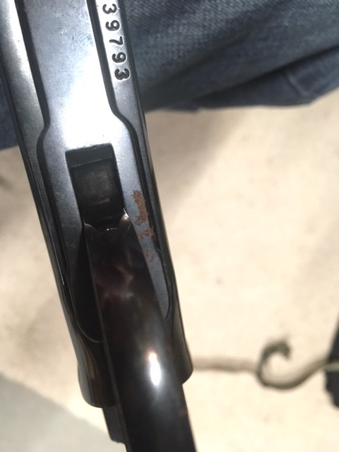

A few before pictures of the 7600's just to show some of what is obviously dealt with when rifles are stored in damp conditions. It will get to anything and everything.

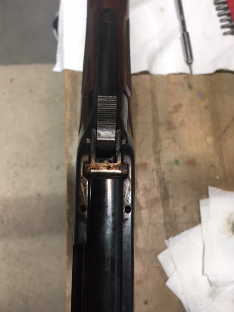

Rusted ring screws.
Underside of 1 of the 7600 barrels, don't remember which one.

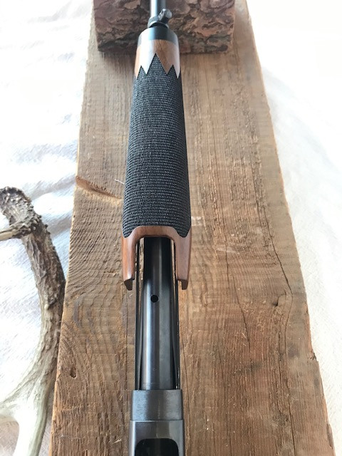

First up is the 30-06. This was the one rifle that was fully functional the way it sat, but took the most work in the end. Was way more corroded and what not internally than the other rifles.

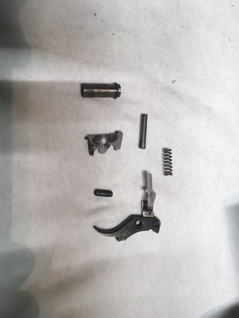

They say not to take 760/7600 trigger groups apart. I do if needed. They are no big deal.
Pic of the 30-06 trigger parts. You can see the rusted seer along with the rusted rear trigger retaining sleeve. Cleaned them up and hand polished the sear and hammer face.

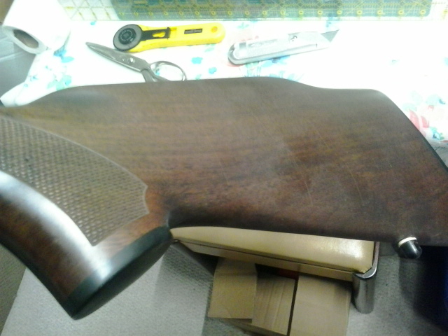

Stock of the 30-06 before. All the rifles wood didn't look horrible from straight on, but from any angle they had a hazy almost dusty look to them, that didn't wipe off.

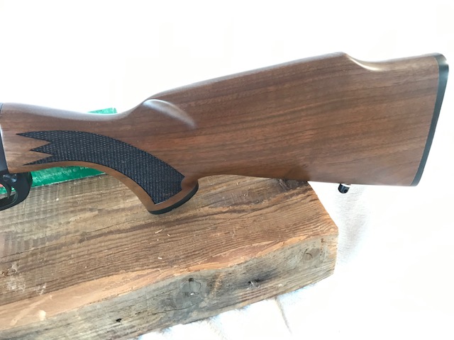

30-06 cleaned up. Trigger breaks at 4 lbs now, didn't test the weight before, but it was horrible with the rusted parts inside.

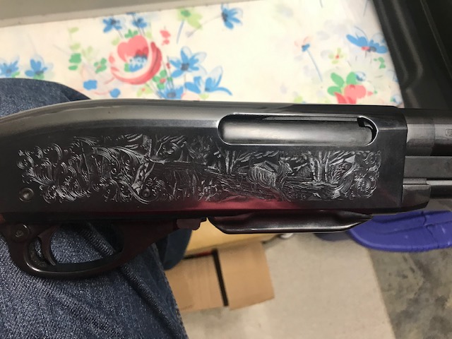

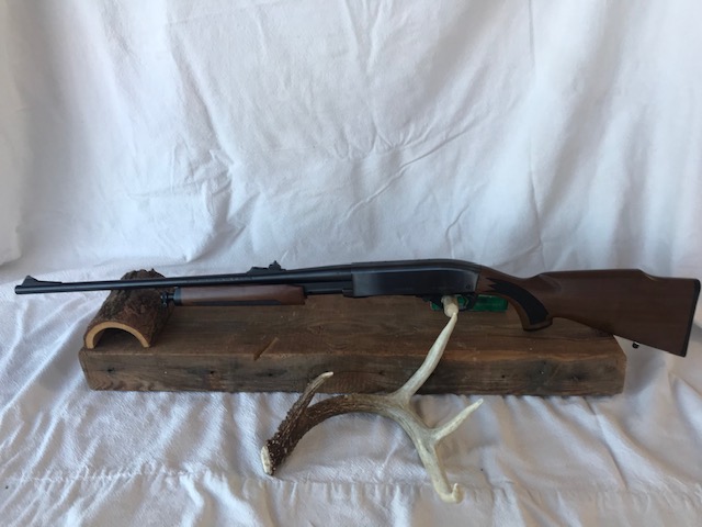

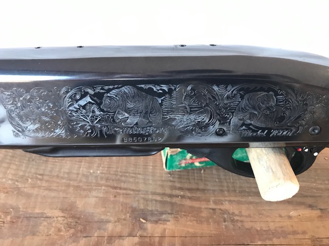

Next is the 7600 243 with the engraved receiver. This one really wasn't bad at all inside despite the action being locked up in the open position intially. Polishing the sear and hammer face got this trigger down to a consistent 3 lbs.
A before pic of the stock on this rifle. That haze looks like it would wipe off like dust, but it wouldn't. Took some polishing.

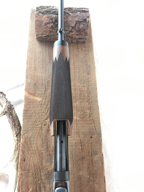

Cleaned up. This rifle has a darker rich looking wood than the 30-06 does.
The mark on the rear of the receiver is from a loose scope mount rubbing.
Pics of the engraving. Bears on the left side, whitetail bucks on the right.

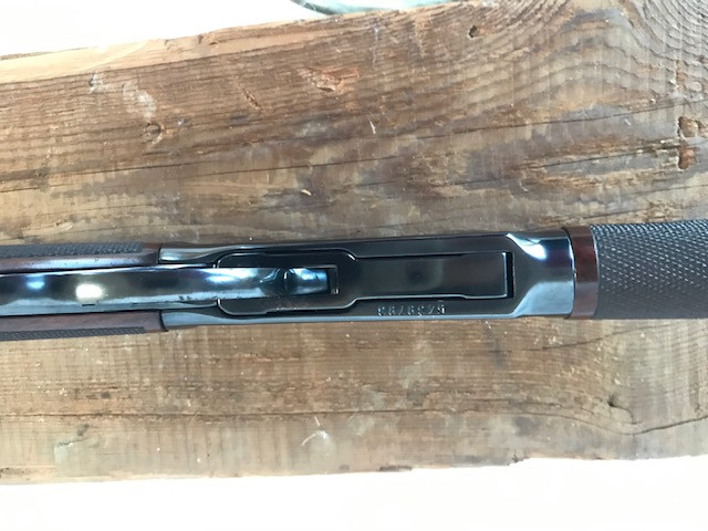

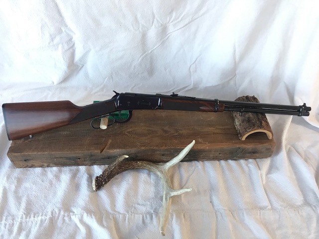

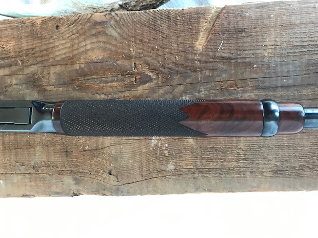

Next up is the Winchester M94. Rusty at spots, and just plain ole dirty and gummed up inside and out. I was a little leary of tearing this apart after tearing apart a Winchester M71, but this was easy peazy compared to the M71.
Like the other 2 it cleaned up very well. I was really happy with this rifle as it was the roughest of all of them when you really got to looking at it.

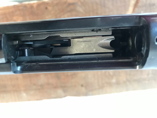

Internal receiver parts after they were cleaned up. Didn't take a before pic, but you get the idea of what this rifle was like.
After pics. I could see this rifle had some nice wood underneath and it cleaned up well. The bluing also polished up very nicely.
Pic of the internal. Clean as a whistle now and the action works slick. Rewarding work. Now I'm looking forward to shooting all 3.

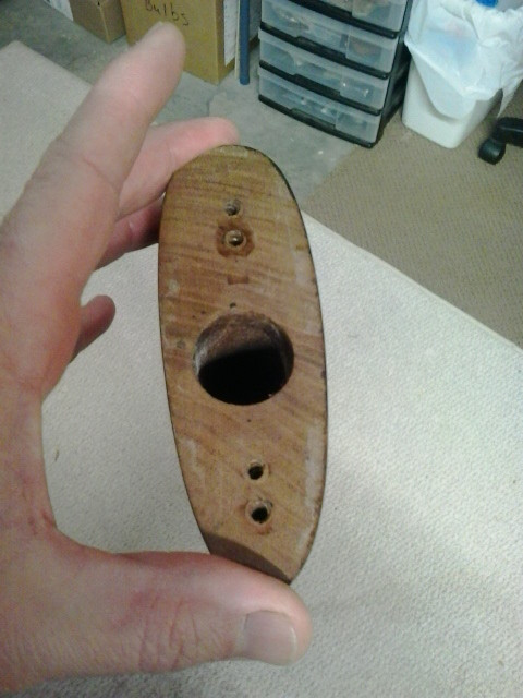

Last pic I forgot to mix this one in at the beginning. Pic of one of the 7600's with the butt plate removed showing the untreated wood. I removed the butt plate and treated and waxed the bare wood on all 3 rifles.
