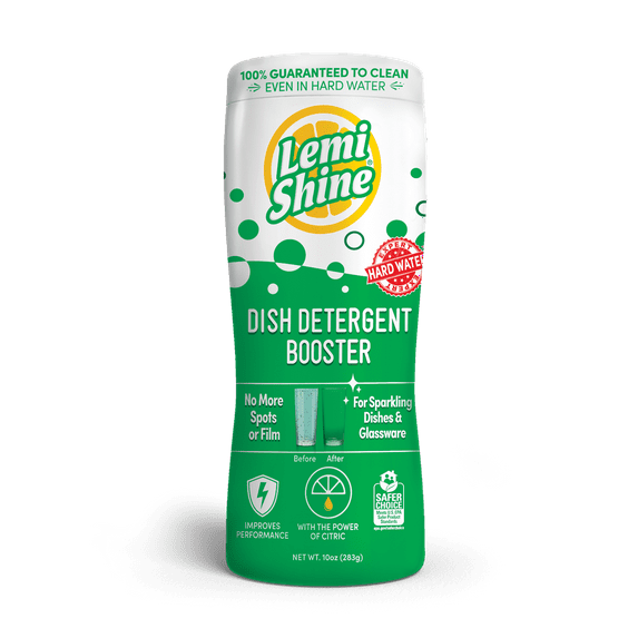

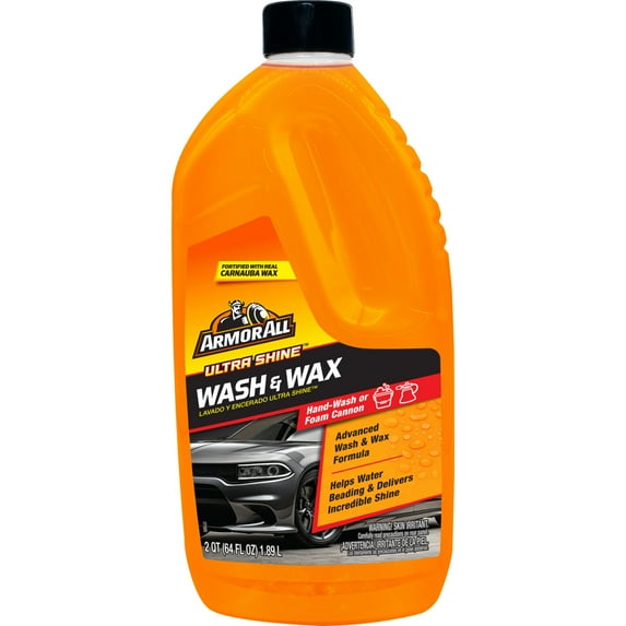

I decap first, then use a Thumler's Tumbler; tumbling with SS pins, water, 1/4 tsp amount of Lemi Shine and a capful of ArmorAll car wash soap. I then dry them using a re-purposed jerky dehydrator.

After sizing I remove the lube using a vibratory cleaner and corncob media. I then expand my case necks using Redding Imperial dry case neck lube and an expander mandrel leaving the dry lube in the case neck to prevent cold welding of the bullet to the brass.
