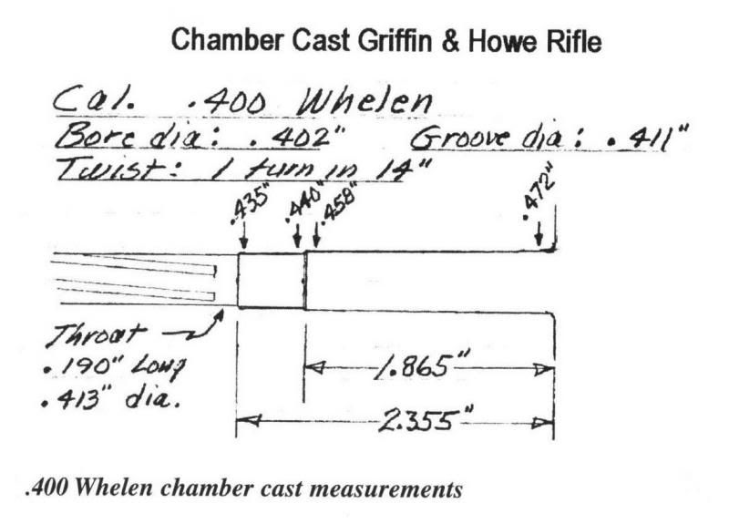

My concern with the .400 Whelen would be headspace with only .009 inches on each shoulder to set headspace from a partially formed die full length resizing. Just a challenge?
It LOOKS tricky, but how difficult can it be? It seems to me that if your sizing die is a decent match to your rifle's chamber then careful die adjustment would be all you need to rock and roll. On the other hand, I've never tried this one so what do I know?
I'm thinking the same as you Charlie, but I would think any of us on here could easily make it work. A decent headspace gauge and a little time adjusting the die and it should be good to go.
We deal with .0015-.002" pretty often, so I would think with some careful work, we would have it set up correct. Maybe a little bit of a false shoulder to get it fireformed perfect would assist right outta the gate?

Taylor, I would LOVE to see those pictures. The more I think about it, the more I'd like one. Talk about an elk/moose thumper. Pretty sure JES could turn any decent 30-06 into a 400 Whelen pretty easy. I think they run about 250-300. For a cut rifled barrel, can't hardly beat that price. I would be beside myself if I could have one built on a Pre 64.
