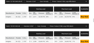

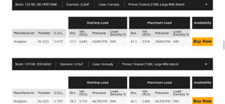

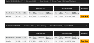

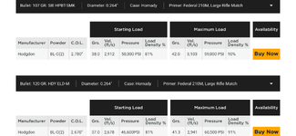

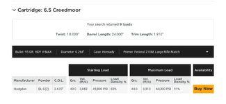

Over the years I have had good results using the BLC-2 powder in everything from 222 Remington through to the 308 Winchester. I haven’t found any data on using this powder in the 6.5 Creedmoor so I’m wondering if anyone here has experience with this combination? Or knows where to find data?
It wouldn't be an ideal case fill, but the powder would work.
