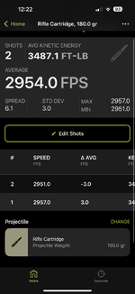

Today I’m dialing her hunting rounds in (189g AccuBond, Nosler brass, WLRM primer, H4350 62g). I’ve ran this load all last year for her and get sub MOA with speeds around 2970’s. I tried seating her .050 off the lands, previous was .033, just to see if it dials in. Stuff bolt as usual but it’s also making a click at the end. I’m not sure if it’s the dreaded clicker, or if the bolt is an issue.
