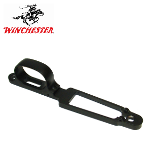

I'm looking for someone that has extensive model 70 experience or to get contact info of someone who does.
I am looking into how to convert a model 70 super shadow into a model 70 ultimate shadow or featherweight tyoe sans the bolt itself. The ultimate, whether SS or camo and featherweight all gor the pre-64 crf bolt but the big thing is the drop floor plate!!
The super shadow is a CRPF bolt with an internal mag.
Basically the only thing I'm interested with this is the magazine area. I want to convert this to a drop floor plate like the pre-64 guns have.
I know a new stock will be required.
Trying to find out the following if.....
#1,
this conversion is even possible.
#2,
If so, what components are needed to obtain for this to work.
Thx for any and all replies, insight, etc

for awhile they stopped making the crf, but did see where they offered it again. do you know what the screw spacing is? and does it have 2 screws? from pics of the pt&g i haven't been able to find out? are you converting the stock to accept the bottom metal or just getting another?
something like this?^^^^^^^

Is this the piece you're looking for?
Well...
Thank you sir....
that's what I need
And I've seen these parts available
But..
BUT....
What i need even more is concrete information on what all is entailed to do this.
I need to know if this is plug and play provided I aquire the correct stock.
This is the conundrum. Concrete info on getting this swap to work if even possible in lieu...or rather addition to the stock needing to change.
What cartridge is the rifle you are wanting to convert. You'll likely need a different magazine box and a follower spring in addition to the trigger guard assembly.
Okay, let me get this straight....
You have 2, m70 25wssm's 1 ultimate and 1 super. You want to make the super an ultimate (or other with a drop floor plate)
Why dont you just swap the stocks and see if it works? Use the internal parts from the super to be sure the work with the ultimate stock and bottom metal you have. If the internal box doesn't work, try with the ultimate. The screw spacing should be the same for both wssm's @ 6-3/8", not sure you could get more concrete than that.
Then you just need to search Midwest or Numrich's to find a wssm stock (and internals if needed)
