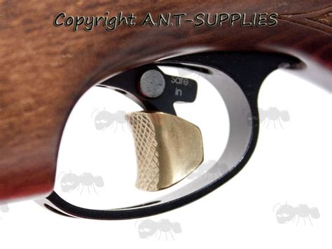

I had not thought of that. Not really a fan of an attachment, but it's worth investigating.
