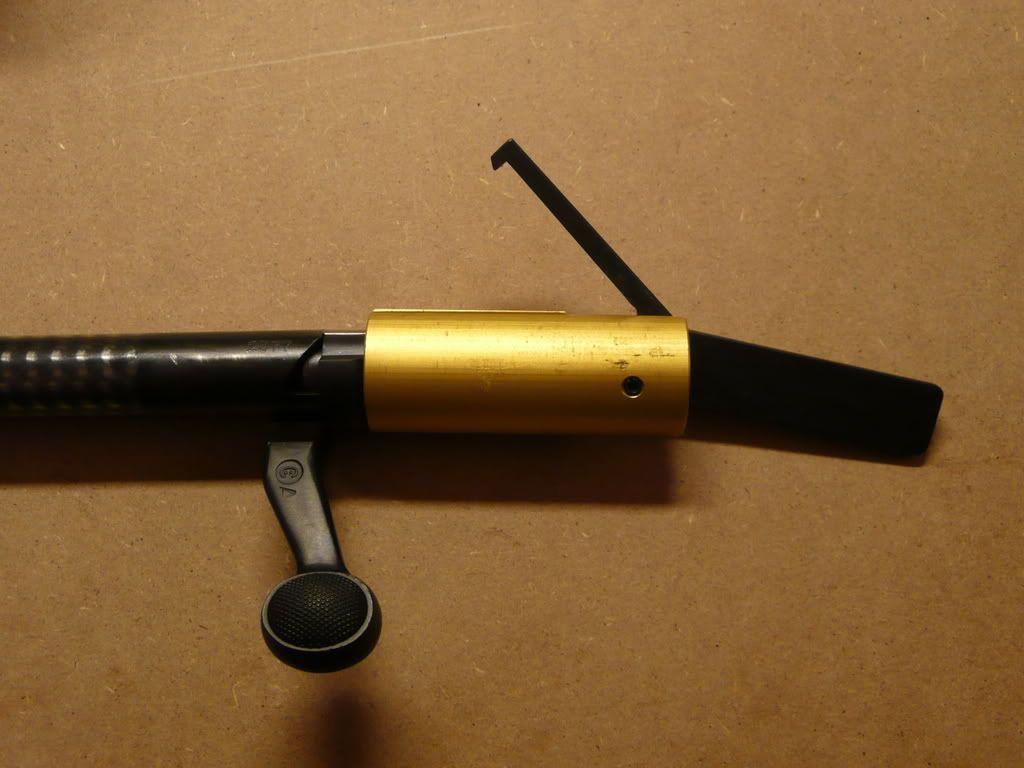

I have the kleinendorst also,here are some pics :)
Thanks for the pictures, he got it apart...apparently the previous owner thought soaking the bolt in cola was a good thing....
