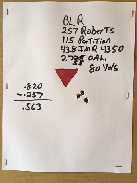

Limited testing so far. Tested it twice with 43.8 of IMR 4350 loaded at 2.785 .030 off the lands. Both times wanted to shoot tight, but had a mediocre flier mixed in.
Not a lot of room to move with this in a short action and these bullets, but I tried the same load .030 shorter at 2.755. According to my measurements I'm .062 into the case body with this bullet at that measurement.
Hot today and I didn't feel like loading up and going to the range. If I pull into a field lane and put the target inside the woods edge, I can get 80yds here at the house. Just shot off the hood of my truck.
Might be getting about as good as I can get with a lever and partitions. Getting where I'm ready to zero the scope and call this combo a wrap.
Did well enough it deserved a post exercise picture. Ha.
The rifle does appear to want to perform for you. And it is handsome, whether pre-exercise or power-exercise. (y)
Nothing to complain about there. Looks good. I passed on a 243 BLR for a very good price when I was young and stupider than I am now. Still regret it.
Group and rifle look great!
That black streak in the buttstock really sets it off nicely.

Thanks fella's. At some point I want to also see how it shoots the 100 gr partitions and the 100 gr speer's. But I'm happy with it with these bullets.

ST,
That is a fine all around bullet and load. Excellent accuracy and a robust bullet to reach the vitals of a deer from any reasonable angle.
The next step is to put one in a big PA buck.

Man, I wanna see the pics! Ha!
HA! Dummy me, I was on post image and seen I was getting quite a few pictures on there so I cleaned it up some, never thinking that was gonna pull it off this site I had posted them on.
Just for you I loaded these 2 back into post image. Ha.
