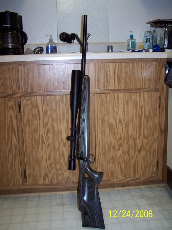

I use H322 in my 204. I use HDY 32gn V-Max bullets and brass. (only thing available when I bought it as that cal. was just released). My recipe is: 27gn H322, GM205M primer, brass trimmed to 1.84", OAL (base to bullet tip) 2.32". I have a Savage 12FV with a 26" barrel and get right at 4000 fps. Although it has a Boyd's thumbhole stock now.
