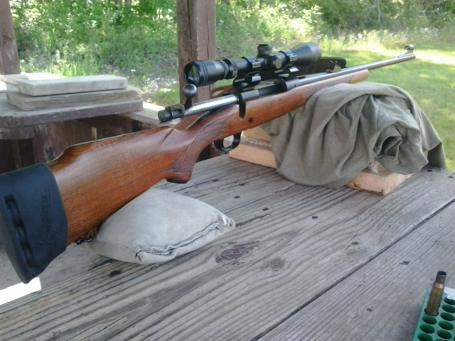

The old 1969 M70 complete with see thru mounts and a heavy cross haired Simmons 3x9. This rifle routinely dispels 2 myths. A. Early post 64, M70's aren't good rifles. B. 30-06's can't hang with 308's for accuracy. :)

It's a Simmons 8 point scope, 3-9x40. Can buy them new for $60-$65. Probably was a $30-$35 scope when my father in law would've bought it new in the mid 90's. Heavy crosshairs.
I should help the rifle out by at least putting a low mount scope base on it instead of that high see-thru, but so far I've left it the way he had it, and can manage to shoot it well enough usually.
