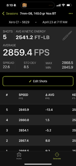

42.5 grains and varget with that bullet was my sweet spot. Looking very promising.
| 7MM-08 | 145 LRX | 47.5/BIG GAME | 2870 fps | .49" | REM brass | WLR | SAVAGE AXIS XP | 2.860" coal |
