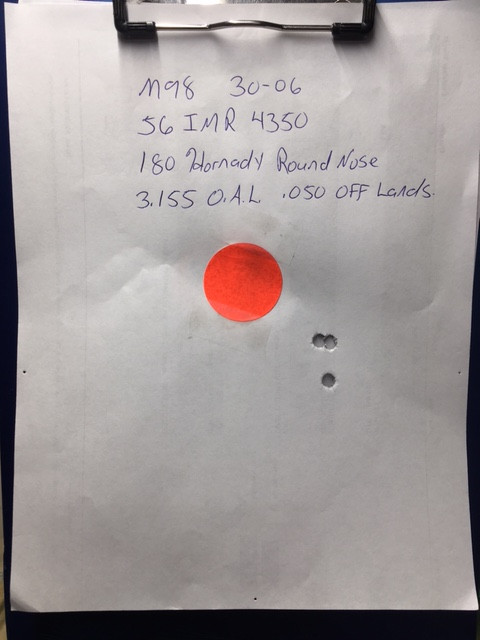

Been pleased with this rifle overall since I worked on it and bedded it. Has shown it wants to shoot everything I've thrown at it with common loads and no other load work up. The only thing it has balked at so far is 150 Speer's with the often used 52 gr's of IMR 4064.
Shot 165 Speer's well with a thrown together load. Today I tried some old 180 gr Hornady round nose bullets and loaded them with 56 gr's IMR 4350. 56-56.5 usually will be in the ballpark with 180 gr bullets. Just loaded them .050 off same as I did the 165 Speer's.

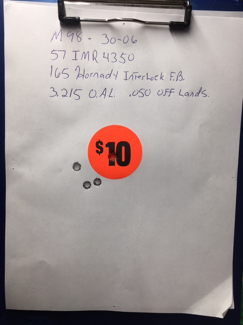

I also loaded 4 with the last 4 out of an old box of 165 flat base interlocks I've had on the shelf forever. Loaded them at the same 57 gr's and .050 off, same as the 165 Speer's.
I had moved the scope over after shooting the 180's, so I believe these will shoot to the same point of impact. Put 3 together nicely enough then a 4'th shot flier in the dot while trying to shoot between heavy winds that had kicked up.....could've been that, or not, don't know till I'd try them again.

That rifle is doing well after your work on the bedding. Looks like you can just tweak the sights on one of those loads and go hunting.

Yepper pretty tickled with it in an old 98 action. At least I know somebody stuck a straight barrel on it.
I can't imagine any of those pre-determined loads of powder charges and seating depths are spot on as being the best for this rifle, yet 3 shot groups have been under an inch with 3 different bullet types.
I have a few of my own way of doing things when it comes to bedding Mauser's, but after a couple successes in a row I think I'll stick to it.
Thanks fella's. Steadily building confidence in this rifle. Just went back and tested the Speer 165 load again this evening with 57gr of IMR 4350. Once again first 4 shots under an inch at 100, then shanked the 5'th trying to put it in with the rest making the total 5 shot group 1.25". I don't weigh bullets, brass, or turn necks. Just a straight up hunting rig. Has turned into a consistent shooter.
4350 has been a stand up powder for me in the 06, not the fastest, but works. Chrono'd this load for the first time this evening.......those 5 shots averaged 2835 from the 22" barrel with an extreme spread of 10fps. (y) A man could kill a lot of game with that rifle.
