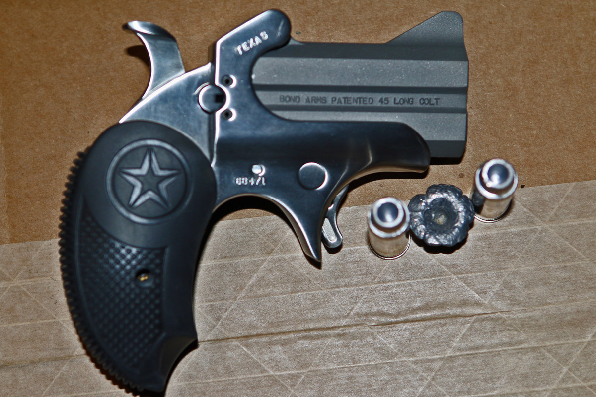

My SD Bond derringer with pure lead 270 grain HP, a one shot wonder, but it carries 2.

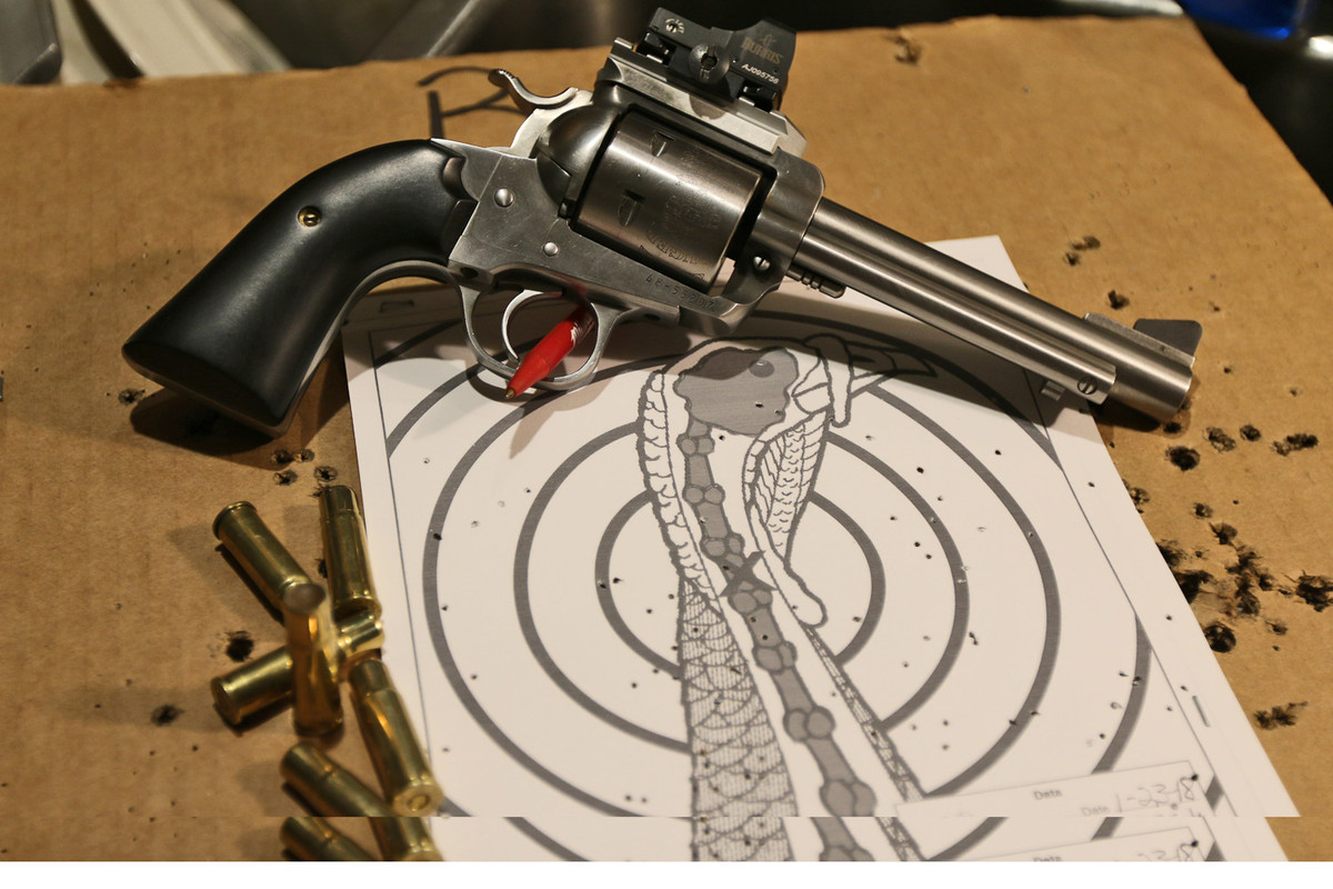

Even lead shot in my 45 colt, using 460 S&W brass forming them in 44 mag and 41 mag to achieve a cartridge that fits the full length of the cylinder and gives me 5/8 oz of #12 shot. Patterns very well from the 5 1/2 barrel at 35 yards.
