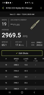

Made it to the range this morning with the R700 223 Wylde, 28" Bartlein HV 8 twist. Loaded up 19 more rounds with the 80.5 Berger/24.5g N540 and did a 10 shot group at 100 and a 9 shot group at 300. By the time I got to 300, the last 4 or 5 shots the wind had picked up a bit and so did the mirage. The far left shot and the 2 far shots to the right were definitely from the wind. I have not yet ran a seating depth test on these bullets, just powder charge. Started at about 20 off and went with it. Could probably do a little better with a seating depth test and less wind/mirage. The ES/SD again isn't great, gotta love the 223 for that right?! Individually weighed to the kernel on the RCBS balance beam. I'm liking the velocity N540 is producing from the 28" Bartlein. I now have 2 decent loads from this rifle with N540, the 75g ELDM at 3000 and 80.5g Berger at 2970. 5 shot groups are typically 3/8-1/2 MOA from 100-500 yards. Now comes the real fun in shooting steel from 500-1200 and getting some good dope. Comment's or criticism is always welcome!
