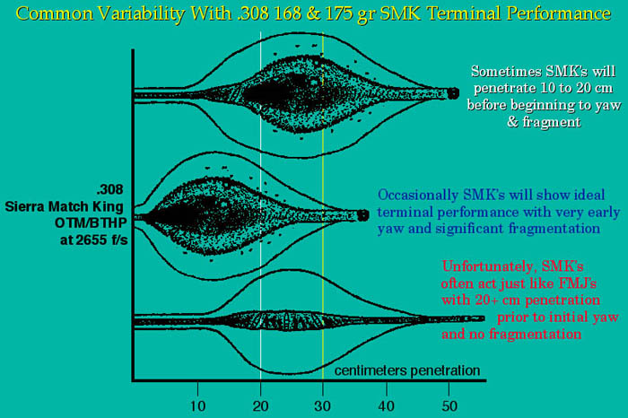

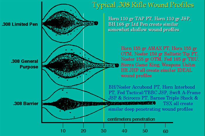

I have some of the 180gr E-tips.The shoot great in my rifle,just haven't used any of the mono's on game.I've been wondering about mono's and how many I see recovered and the nice mushrooms they make.Since they shed very little weight compared to lead core bullets,it has me thinking that lead core bullets,in shedding their weight also blows a cavity that can aid their penetration as long as the lead core and jacket are tough and remain together and exit.I've watched some videos that show mono's tend to expand quickly on impact and then tend to have a smaller wound channel afterwards.I don't know,both bullet types kill,but they do perform a little difference.Having no experience with mono's performance and the type of wound channels they produce,I'd like to hear more from people who use them and how they seem to produce wound channels compared to lead core bullets they have used.
These pictures are kinda what I'm getting at.
