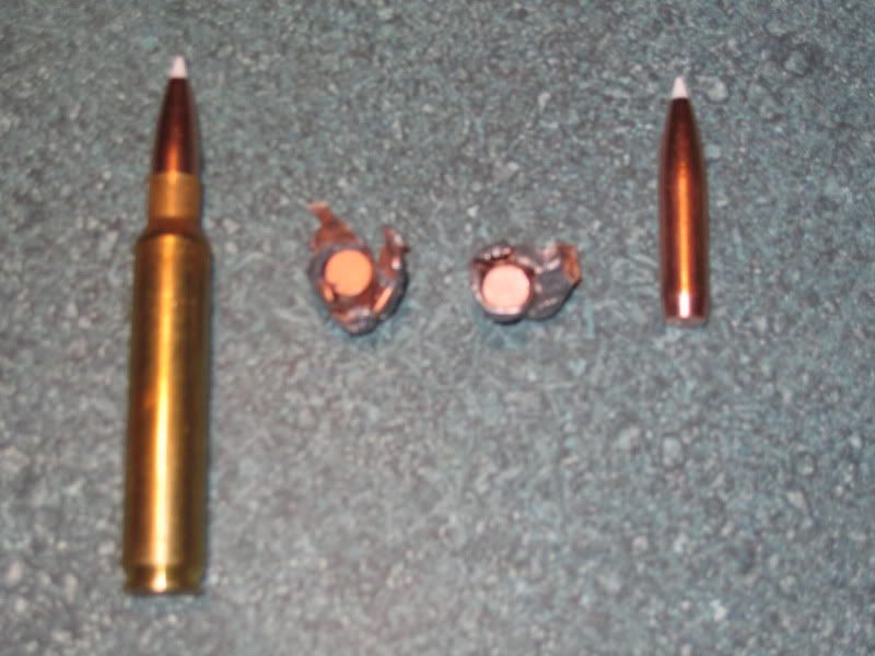

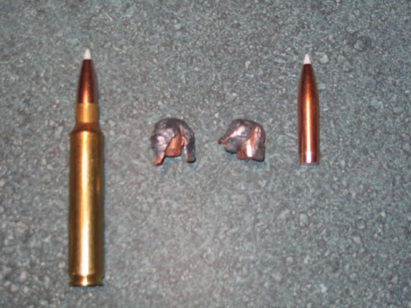

I recovered a couple .338 cal 300 gr AB's from water jugs at 300 yds. Both were recovered in the 8th jug which demonstrates some serious penetration.
MV is 2742 fps and impact velocity at 300 yds is 2369 fps with 3738 ft lbs energy.
Bullet #1 (R) expanded to .740" and weighed 197.0 grs.
Bullet #2 (L) expanded to .755" and weighed 204.3 grs.

Good weight retention; good expansion. What's not to like? Excellent pictures, Jim. Thanks for posting. A tad heavy for my 338 Federal, but you never know what I could end up with on another day.
WOW! That is incredible Jim! What a bullet. Man, you have gotta be really happy with how they shoot. That is exceptional performance and they look like they expand really well. Those kinda pictures make me wanna get a bigger 338!

Looking at that kind of expansion and shedding 100 grains at 300 yards, no wonder I found broken off petals in the jug when I tried to test them at 100 yards. Should be a heck of a big game bullet. I know I'm anxious to run one through something other than milk jugs....
