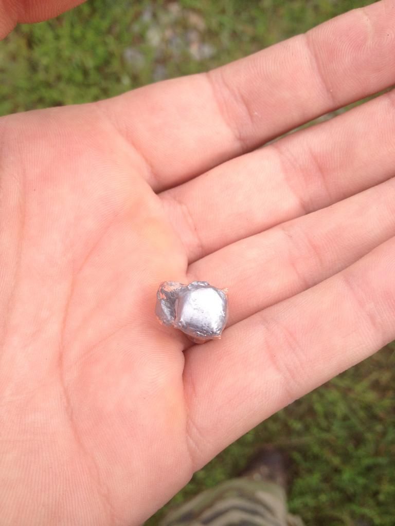

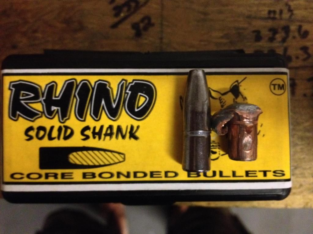

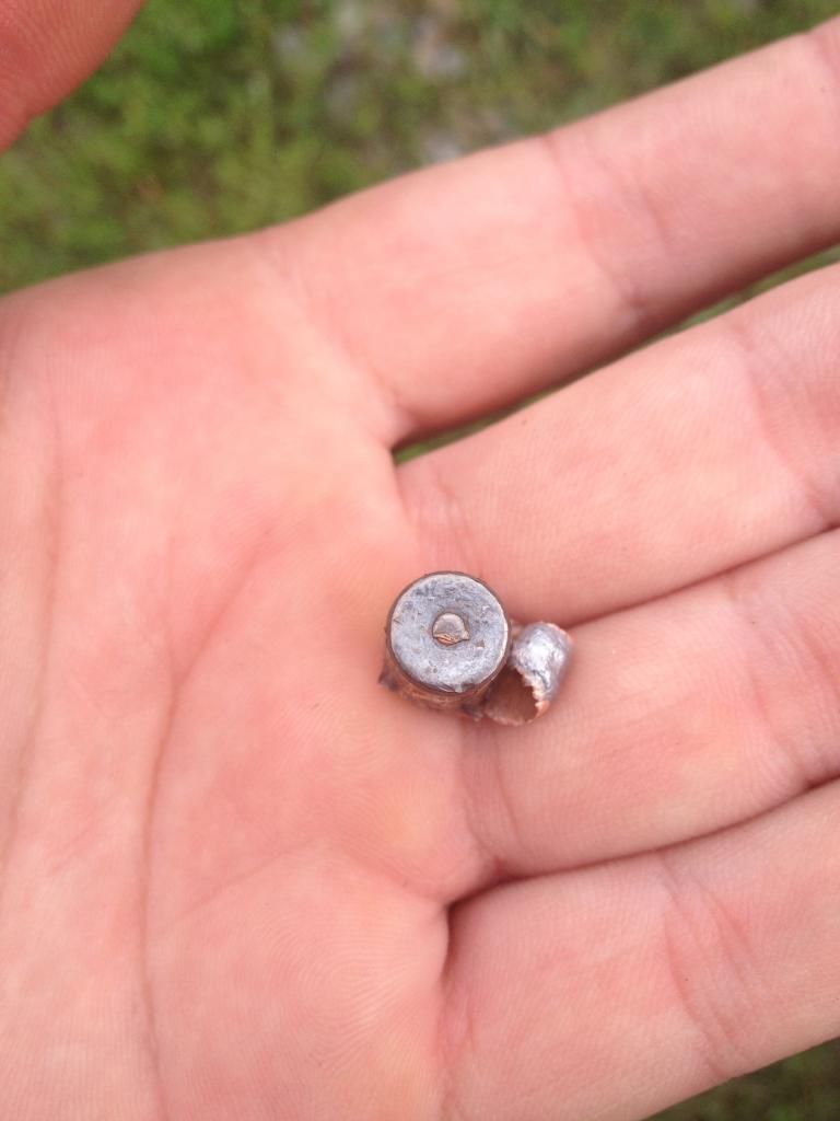

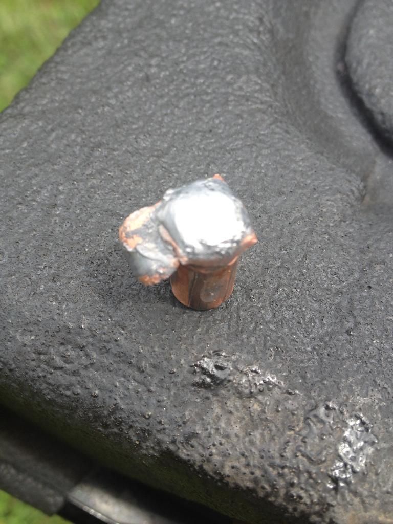

Here is one of the South African Rhino's, This bullet was launched from my 35 Newton at 2700FPS, almost right on the nose. The bullet was found in between jug 7 and 8. It was actually pressed into 8 enough to keep it from leaking. All but one of the petals sheared off and the last petal was just about to shear off as well.

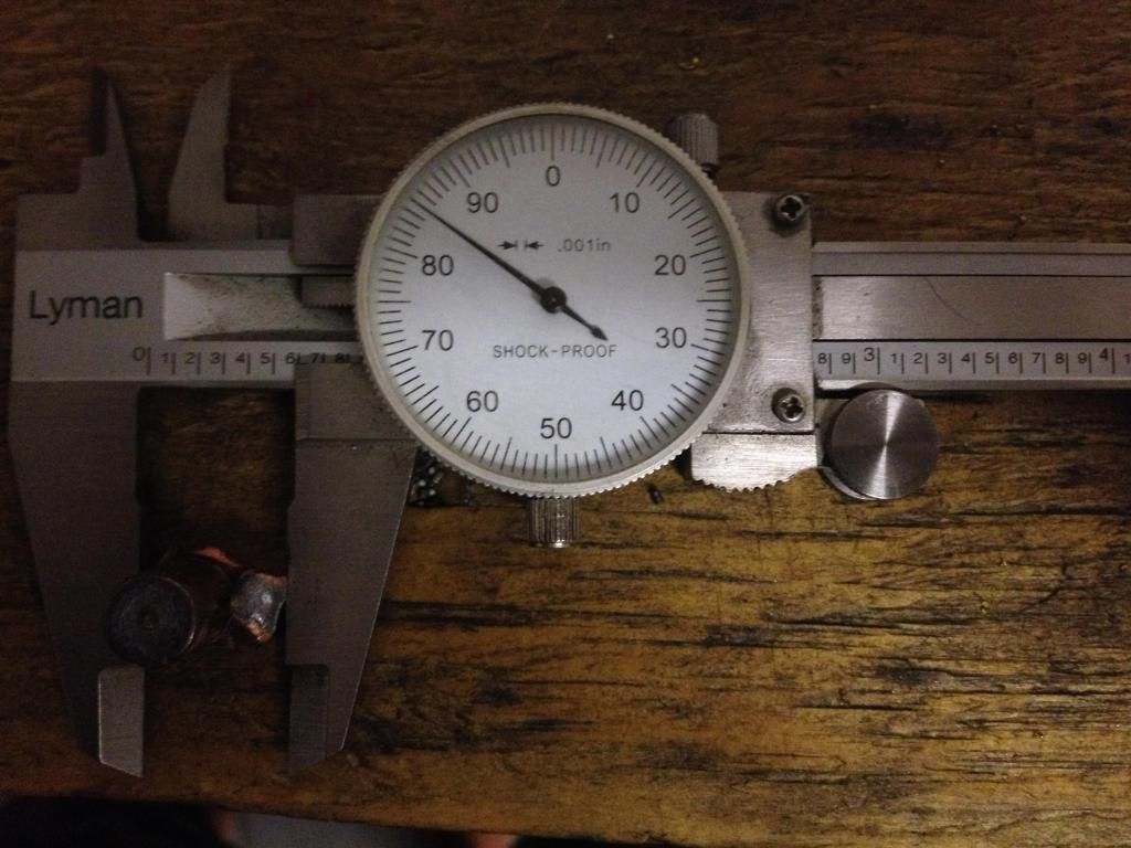

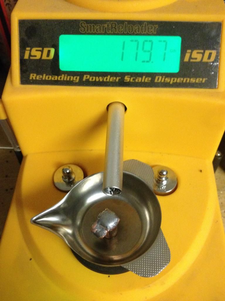

Added a few pictures of retained weight and expanded frontal area.
