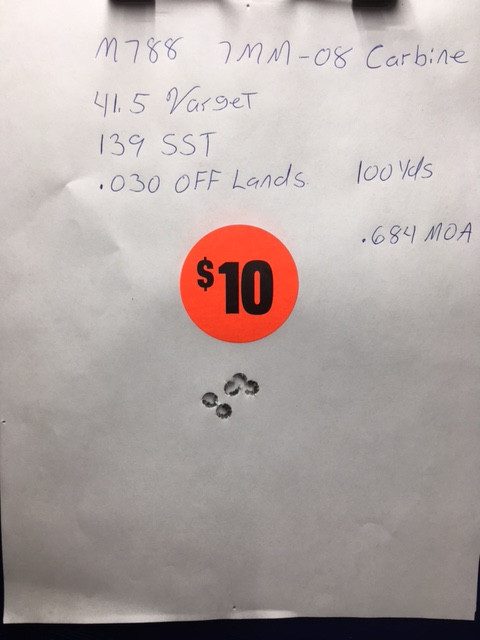

I got a M788 that I threw together a generic load for with Varget that worked well in 2 other 7mm-08's. It put the first 5 shots I took with it at 100 at just a smidge under an inch with that load. Not bad at all.
I've since ran some 130's through this gun and wasn't that impressed. Will deal with them later.
Went back to the 139 load with Varget and this time took a fairly big swing at seating depth just to see what happened. 5 shot group tightened up considerably.
The way they came from the factory bad trigger and all, the 788's still show why they garnered their much deserved reputation for accuracy.

By the way that group is a good example of why I've been straying farther away from relying on 3 shot groups. Other than to check an already established good shooting load.
A 1 off snapshot of a 3 shot group by itself doesn't tell you much and can often give a false positive of actual likelihood of rifle accuracy. Unless those 3 shots can be repeated with almost non stop regularity.
The sequence of shots were such that I could've stopped at either the top 3 shots which measure in the low 3's, or take the far left shot of the top group and use it with the bottom 2. That 3 shot group measures in the low 4's. Both significantly smaller than the actual group size which is .716.

Yeah a really tight 3 shot group that felt right at each shot is likely that you're on to something, but I still don't trust them without farther testing. Been bit before with that assumption. When 4 or 5 shots group good, it is substantially more unlikely that was just a random happening within a larger group, in my opinion.
