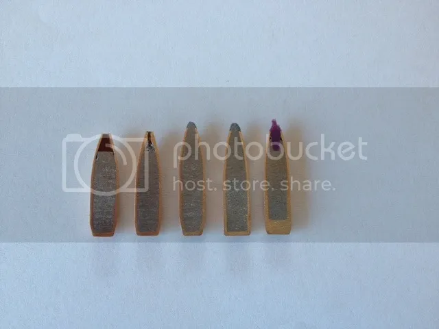

Here is a picture I took 4-5 yrs ago of some sectioned .243 bullets. Old enough that it was stored in photobucket and they have their logo over it since I no longer use that service. You can see in the photo the BT has quite a heavy base compared to the others. Not an endorsement since I haven't used them, but just an observation.
From left to right.
1. Sierra GameKing 85gr HPBT
2. Hornady 87gr HPBT
3. Sierra GameKing 100gr Spitzer Boat Tail
4. Hornady 100gr Interlock Flat Base
5. Nosler 95gr Ballistic Tip
We have been using 243 with both bullets for many years. If in heavy cover lean towards the PT, For everything else either one is fine. I personally use the 95 BT in mine. The 95BT has a tapered jacket. Look at the photo. It mushrooms and hangs together surprisingly well.
