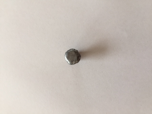

Not a lot of bullet selections for the 348, but Swift started making a 200 grain for it in their A-Frame lever series of bullets.
Swift's claim is they revamped these bullets specifically for the slower lever cartridges. They are supposed to expand all the way down to 1200 fps.

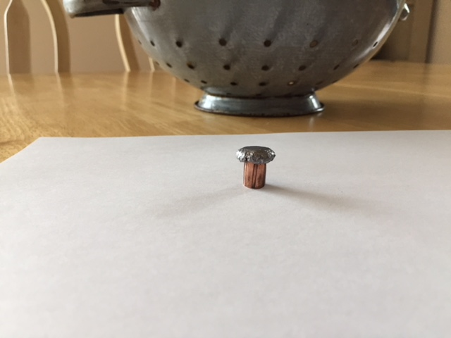

I'm launching these at 2510. Jug tested 1 of them from a distance of 20ft. Obliterated the first several jugs and I found it in the 7th milk jug, roughly 40" of penetration.
It expanded to a uniformed mushroom of .615.
Retained weight was 194.5 grains, so 97% weight retention.
If on game performance proves anything like what the test showed, this is one heck of a bullet for the 348.

Reminds me very much of the 350 gr Swift A-Frame I tested from a 45/70 long ago. Very similar performance.

Bear crusher? Well, I guess! I have always liked Swift bullets, and the A-Frame has had a place in my recommendations for multiple cartridges. That is great performance for that bullet--penetrating into tomorrow and expanding as it does. Great post.

ST, I think you'll find that Swift will do EVERYTHING the heavier bullet will do and probably give a touch less recoil as well. Either way, 220/221, whatever it takes!
I suspect you're correct on both counts Scotty. I looked at the 250 grainer's including the Barnes. The Swift's are certainly more expensive, but I figured I'd try them and the way it worked out I might even try them on deer. Way more bullet than needed, but with that speed and easy expansion they might have plenty of shocking power at woods ranges on light game even though they're a very tough bullet. Possibly a mouse to moose setup with 1 gun and 1 bullet.
